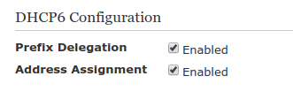

            I also see on AT&T 5268 AC modem following additional settings:
            The modem also has following DHCP6 settings enabled
            Also I used "prefix ID =1" on LAN1 and "prefix ID = 2" for LAN2 on pfSense, if I do not use these setting then LAN1 and LAN2 does not get any IPv6 assigned
                That looks like your modem is in gateway mode, which means pfSense can't pass on a prefix to devices behind it. Can you put that modem into bridge mode?
