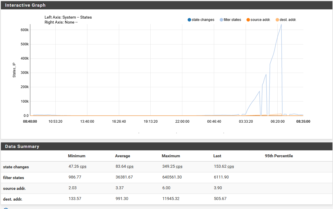

                    • B Offline
                      bokikay @Derelict
                      • DerelictD Offline
                        Derelict LAYER 8 Netgate
                        It looks like you have significant stability problems there. 300 state changes is nothing. literally nothing. Not sure why you disabled showing total states though. I would be looking for faulty hardware based on that.

                        • DerelictD Offline
                          640K max states is significant though. You would want to find the reason for that. With 8GB setting max states to something like 2,000,000 would not break anything in and of itself. But 640K states is a lot if you don't know why they are there.

                              • DerelictD Offline
                                That is a lot of states. Does it make sense that those all exist in your environment?
