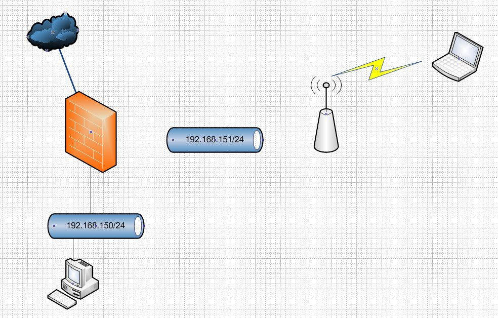

Something as simple as this does what you want
That other segment connected to pfsense could be just another port on pfsense, a vlan etc. on your lan interface.
If you have a vlan capable switch and AP that can do vlans you can get as fancy or as simple as you want.
You can allow or block whatever access you want between the segments - and your only natting once to the internet from any of your segments.
btw when using your wifi router as just AP, pfsense will provide dhcp to your wireless clients.
