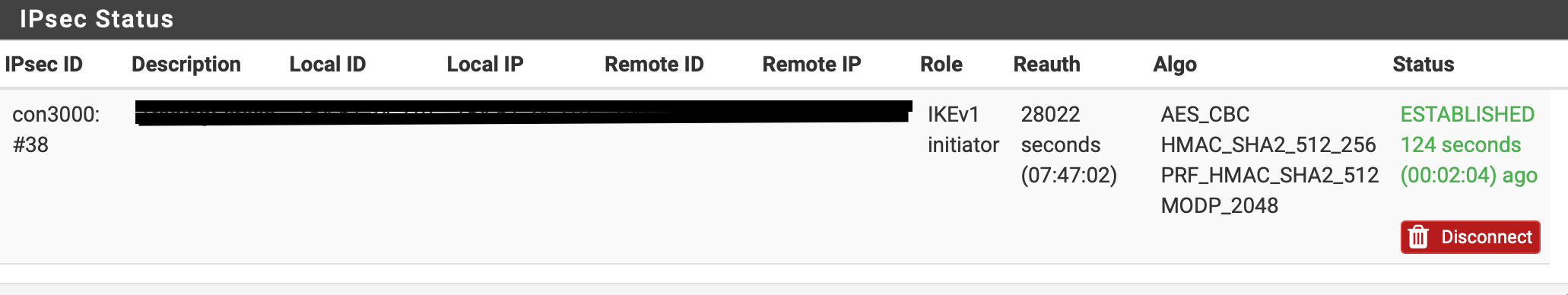

      Recently I setup site to site VPN with remote Cisco ASR platform. While IKEv1 phase1 is established I can not make phase2 even be triggered by SA traffic:
      While sniffing traffic towards remote tunnel destination in tcpdump I see only IKE traffic, but not ESP (tcpdump -ni <ifname> host <remote_tunnel_endpoint>):
      While triggering phase2 establishment by pinging the destination behind the remote end of this tunnel I see traffic in tcpdump coming from LAN interface, but see nothing in tcpdump of enc0 interface, so the packets are just silently dropped. In a firewall configuration regarding the IPSec interface I have allow any any rule.
      Please advice what could be investigated in addition. Thank you.

          I didn't find much errors there, only:
          03[ENC] <con3000|127> received unknown vendor ID: 38:00:7c:6d:d6:5c:c8:cf:2a:ea:90:30:a6:22:81:1e
          which might relate to encryption process. At this moment I can only try to trigger phase2 only from my side, tomorrow I might have some cisco debug logs from the remote side. But the fact that it doesn't trigger phase2 establishment already indicates a problem. And it's not VTI tunnel. What else could be checked?
          • jimpJ Offline
            Based on the log messages, I'd say the remote side is rejecting the Phase 2 for some reason. You'll have to increase logging/debugging on that side and see what it says.
            That or try initiating in the opposite direction.

              shshs @jimp
              @jimp said in Phase 2 is not establishing:
              Hi @jimp, what makes you think so? In my understanding if phase1 is established (which is true in this case) then ESP traffic is generated ( triggered by interesting traffic ). But I dont see any outgoing ESP packets on my end. Iโ€™m also looking for incoming ESP, but itโ€™s not under my administration, so it will take some time to manage. I still dont understand why pfSense does not generate egress ESP. Thank you.
              • jimpJ Offline
                ESP is "phase 2" traffic, so you won't see it until Phase 2 is established, which still happens during the exchange on udp/500 or udp/4500.
                This section in particular is part of what makes me think it's the remote end:
                Your side sent a request for a child SA:
                Nov 19 17:36:25	charon		11[ENC] <con3000|131> generating QUICK_MODE request 44131316 [ HASH SA No ID ID ]
                Nov 19 17:36:25	charon		11[NET] <con3000|131> sending packet: from <MY_SOURCE_IP>[500] to <REMOTE_IP>[500] (284 bytes)
                Though the timing looks like it received a reply, it did not. The remote side sent a command to delete a child SA (which didn't exist):
                Nov 19 17:36:25	charon		11[NET] <con3000|131> received packet: from <REMOTE_IP>[500] to <MY_SOURCE_IP>[500] (124 bytes)
                Nov 19 17:36:25	charon		11[ENC] <con3000|131> parsed INFORMATIONAL_V1 request 2873368022 [ HASH D ]
                Nov 19 17:36:25	charon		11[IKE] <con3000|131> received DELETE for ESP CHILD_SA with SPI f780296d
                Nov 19 17:36:25	charon		11[IKE] <con3000|131> CHILD_SA not found, ignored
                Then your side retransmits the initial request with no response:
                Nov 19 17:36:29	charon		05[IKE] <con3000|131> sending retransmit 1 of request message ID 44131316, seq 4
                Nov 19 17:36:29	charon		05[NET] <con3000|131> sending packet: from <MY_SOURCE_IP>[500] to <REMOTE_IP>[500] (284 bytes)
                And then it retransmits again.
                All signs point to something on the far side either ignoring your requests or failing to parse them for one reason or another.
                Do not Chat/PM for help!
                  shshs
                  @jimp
                  You were exactly right, the issue was on remote end. Thank you very much for your help, it's good to have such experts like you here. Good luck you to you.
                  SOLVED!
