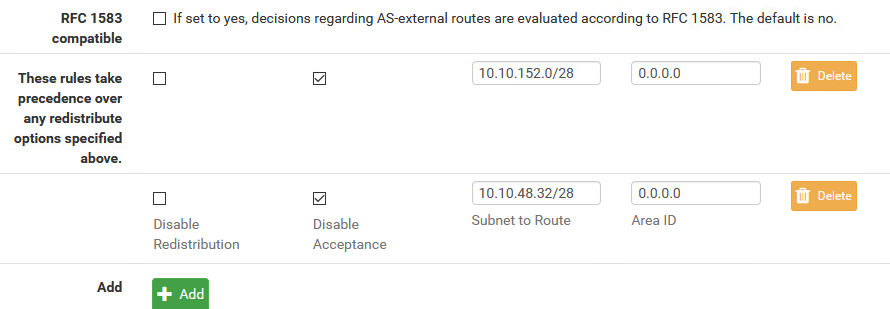

      Hello, can anyone tell me how to filter out a route using pfsense and Quagga? I have a configuration that is working just fine, but just need to prevent two routes from entering the routing table.
      my config is pretty basic at this point.
      router ospf
      ospf router-id 10.10.15.1
      network 10.10.15.0/24 area 0.0.0.0
      area 0.0.0.0 authentication message-digest
      I'd like to prevent the router from learning the following two routes..
      10.10.152.0/28
      10.10.48.32/28
      Regards,
      Adam Tyler
      • jimpJ
        On the FRR Global Settings tab, add entries in the Route Handling area for those subnets with Do Not Accept checked.

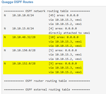

          AdamTheManTyler @jimp
          @jimp I found that area under global config, but it doesn't seem to make any difference. Routes I am trying to prevent still seem to display in both OSPF and Zebra tables...
          It's strange, even with the "Disable Acceptance" box checked, it still seems to just add a network statement under the OSPF process.
          Take a peek...
          • jimpJ
            Sure they show there but they are not active. They have no > so not selected. They have no * so not in the FIB. Check the actual system routing table, they should not be present there.
