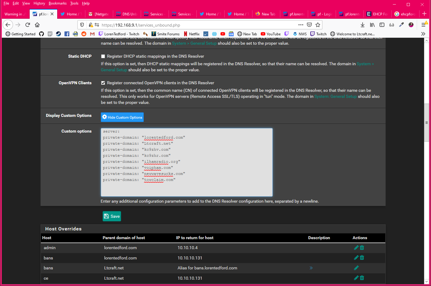

            These are public domains and the goal is to have them NATed to my webserver however now pfsense is claiming https://lorentedford.com how do i fix this?

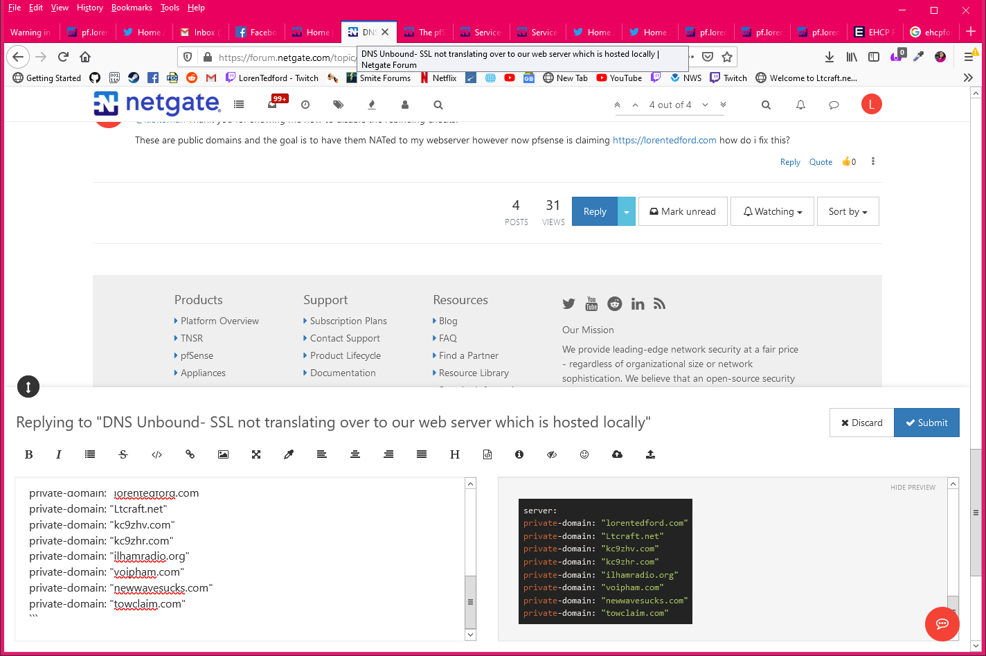

              By the way your spam protection sucks.. It didn't allow for me to past the contents of the custom options in code for some reason here is that screen shot..
              You guys might get that fixed..
