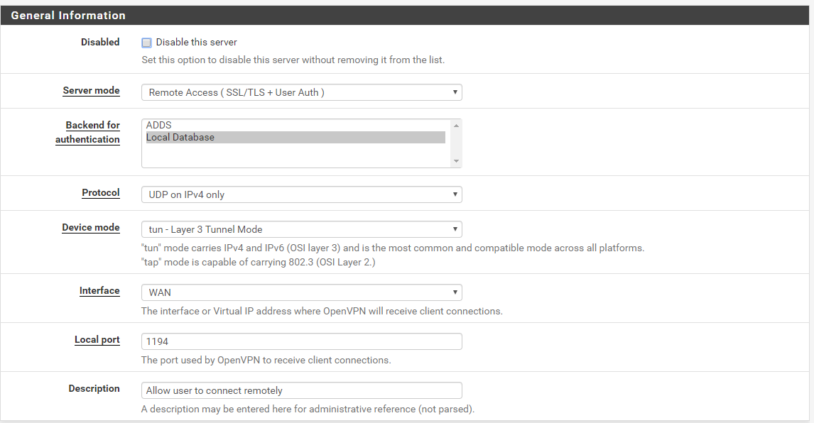

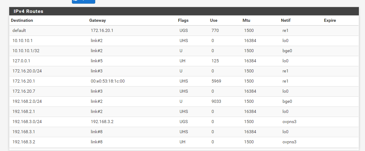

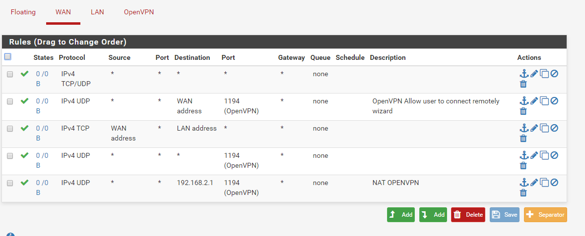

                  • K Offline
                    koko_adams

                          Yes, that 165.x.x.x public IP does not appear in the routing table so you are behind the NAT of that cellular router. You will need a port forward in place for that in the cellular router if you cannot pass the public IP to pfSense directly.
                          You can see on the WAN firewall rules that 0 packets and states have been passed by the UDP 1194 rules. No traffic from the client is reaching pfSense currently.
