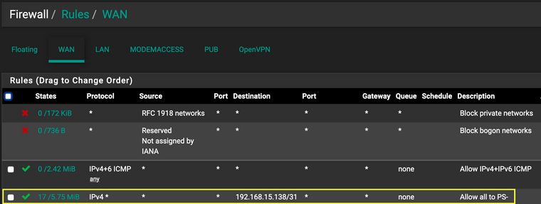

                I've now set each PS to have a public IP with 1:1 NAT for each virtual IP and allowed all traffic from the WAN to each PS as per below:
                Tested this worked by visiting ShieldsUp from the PS and all ports are showing closed instead of stealth.....as expected and shows the public IP expected from the 1:1 NAT.
                No matter what i did, if one PS had one of the public IP's and the other just normally NAT'd then one PS would always have moderate NAT. They seem happy to both have a public IP so i'll go with that and i'll look to disable the allow all rule later this evening when gaming has ceased to see if it makes a difference :)
