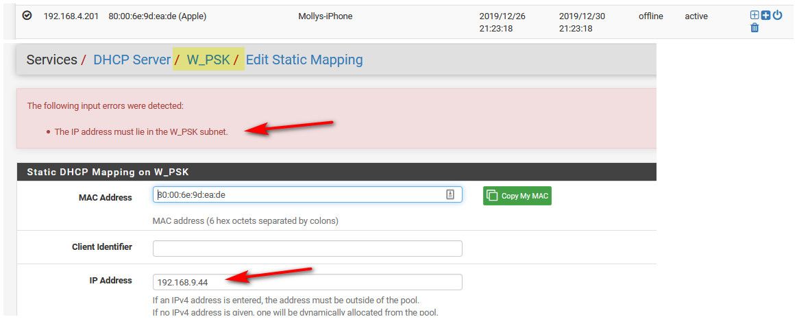

                  justas
                  Depends on how you opened the dialog!
                  If I click on "+" in the "DHCP Leases" and enter an IP from a wrong VLAN, I get exactly the error you posted.
                  But I created the mappings directly from the "DHCP-Server"/VLAN:
                  That dialog didn't bring any errors, mappings were created.
                  • johnpozJ Online
                    No same error.. Those IPs are in the same subnet..
                    Clicking that add button takes you to the same place as if you clicked on the add button in the current dhcp leases.. When you click it in the dhcp leases, its just going to take you to the dhcp server for whatever vlan that IP is currently in, and prefill the mac address for you.

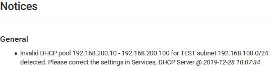

                    Are you changing the IP subnet of the interface, after you have created the statics?
                    example
                    192.168.100.0/24 on vlan
                    Static mapping
                    192.168.100.100 for some client.
                    Then change the interface to 192.168.200/24 or something... then yes those mappings would be wrong.. But it warns you about changing your IP range, etc. And while the dhcp mappings are wrong - is that what your doing?
                    So no that client sure wouldn't work... But other dhcp clients in different vlans would be fine... After I created the bad scenario... clients still getting their dhcp leases, etc..
