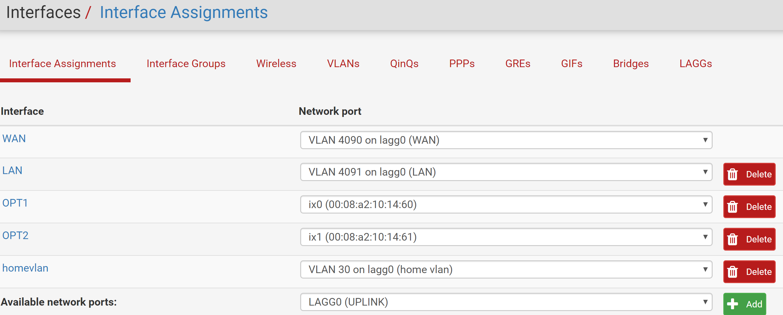

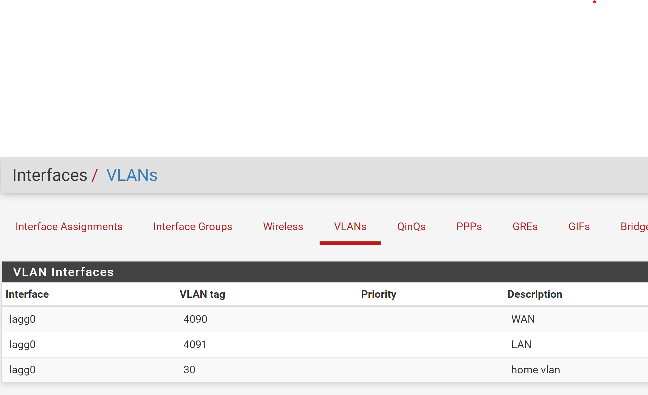

      I have a new netgate XG-7100 1U. I have what I think is a simple setup that I can not get to work on here. My WAN and LAN interfaces work fine with the default VLAN 4090 and 4091. My problem is I'm trying to just add a vlan 30 with a address of 10.1.30.1. I'm able to configure that fine and I'm able to ping that network from the default vlan 4091. I made sure dhcp is configured and I also added that network on the swith and tried assigning different ports. But no matter what i do I can get that network to work when i attach to it. Is there something I'm missing here or something I'm doing wrong?

        firewall rules on the homevlan interface passing traffic you want to pass?
        Chattanooga, Tennessee, USA
          What you have setup there looks correct. Do clients get a DHCP lease when you connect them to Eth5? In the correct VLAN30 subnet?
