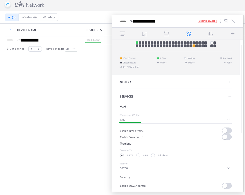

                  I am having trouble getting the pfsense firewall to hand out a IP address to the UniFi switch.
                  Setup
                  The XG-7100 pfSense firewall is connected to the switch on Ix1 SFP port to the UniFi switch's SFP port 49.
                  All Ports are set to "ALL" for the port profile. The management interface is using the UniFi network which is the default network (just changed the name to UniFi since I have a network named LAN).

                    • T Offline
                      ThePieMonster @stephenw10
                      @stephenw10 said in Network Setup Suggestions For XG-7100:
                      ix1 doesn't connect through the on-board switch. You don't need an y switch config present to have that connect.
                      Are you saying that I can delete the VLAN groups 2,3, & 4 in the following screenshot?
                      You would need to be using one of those VLANs as the management subnet in UniFi to be able to 'see' it from anywhere else unless you have ix1 also assigned directly, whcih you don't appear to.
                      So I did change the Management VLAN to the LAN Network I created which got the switch to get a IP address from the firewall that was reserved for it. So that part worked out.
                      Uni-Fi-Services

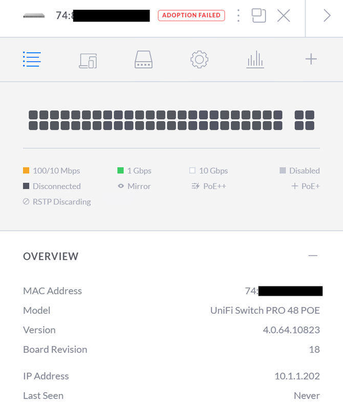

                      However after doing that I can not get the Controller to adopt the switch anymore. The PC that is running the controller software is on IP 10.1.1.250. It is plugged in directly to Port 1 on the switch just like it was before changing the management interface.
                      UniFi-Adopt-Failed
