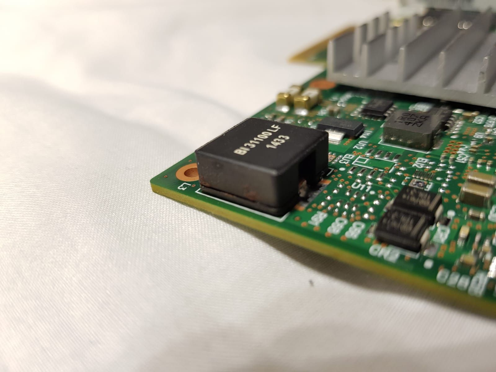

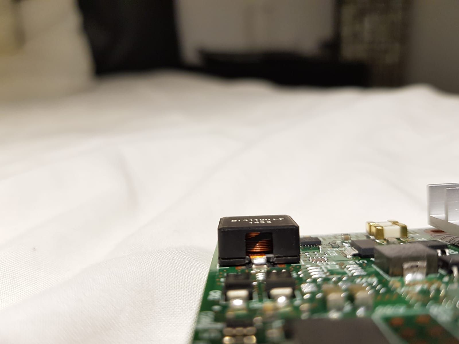

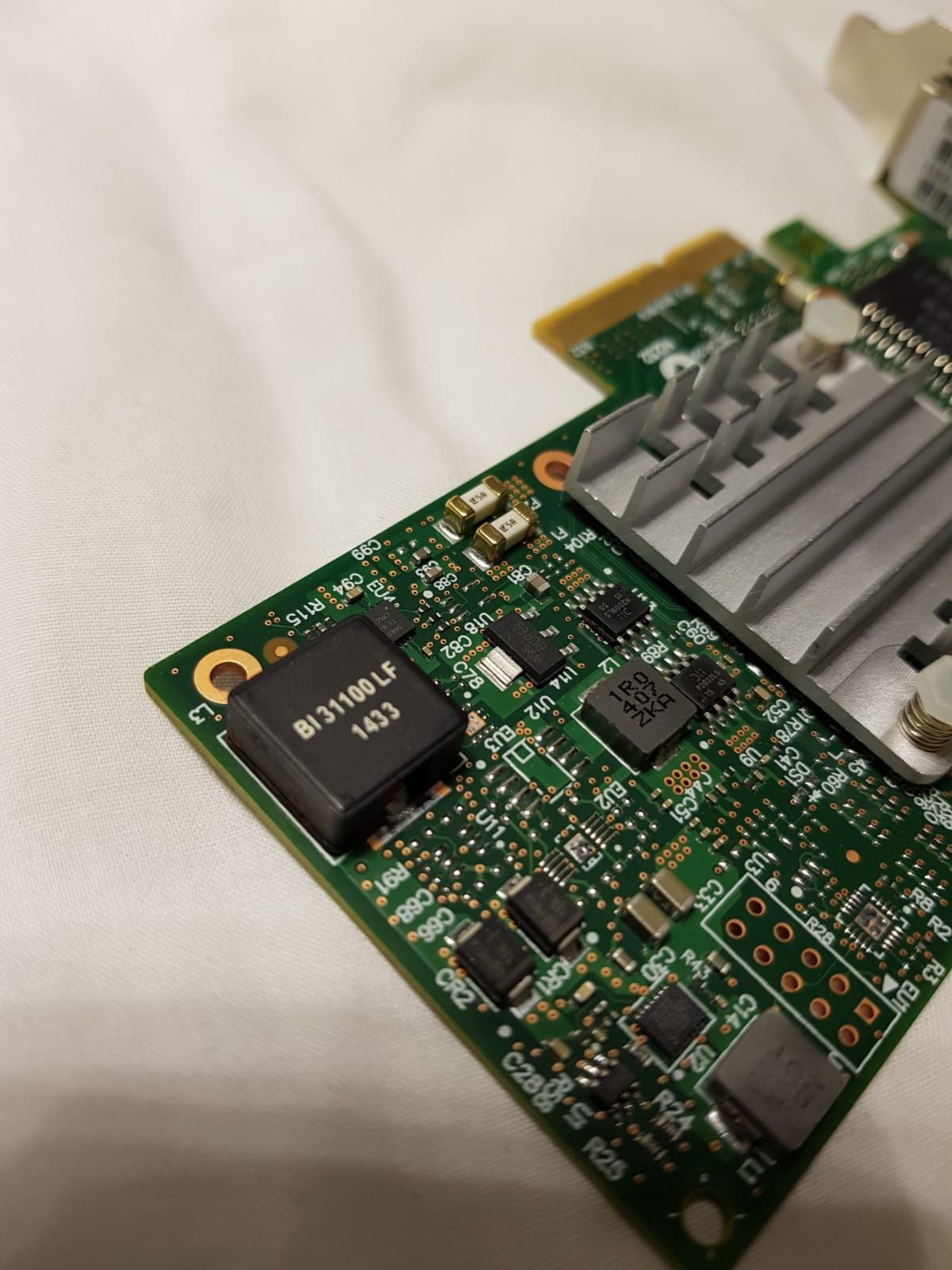

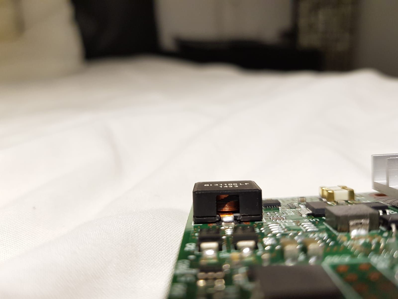

                      and yes I got it from this guy on ebay, now I know its a counterfeit card and it was working perfectly fine until now,
                      I found a topic about this cards here:
                      https://forums.servethehome.com/index.php?threads/comparison-intel-i350-t4-genuine-vs-fake.6917/
                      people report that after a few months they start to fail and I had it over a year and a half, I'm almost sure that the issue is because of the NIC,
                      I checked it and found some corrosion on it, I'm adding a photo of itImage4.jpeg Image3.jpeg Image2.jpeg Image1.jpeg
                        Ouch!
                        Hard to see why that would have caused such problems for Unbound though whilst other traffic was passing. If it loses connection entirely Unbound might use significant CPU trying to connect, though that still looks high.
                        If the card is failing though it could fail in interesting ways, almost anything could happen!
