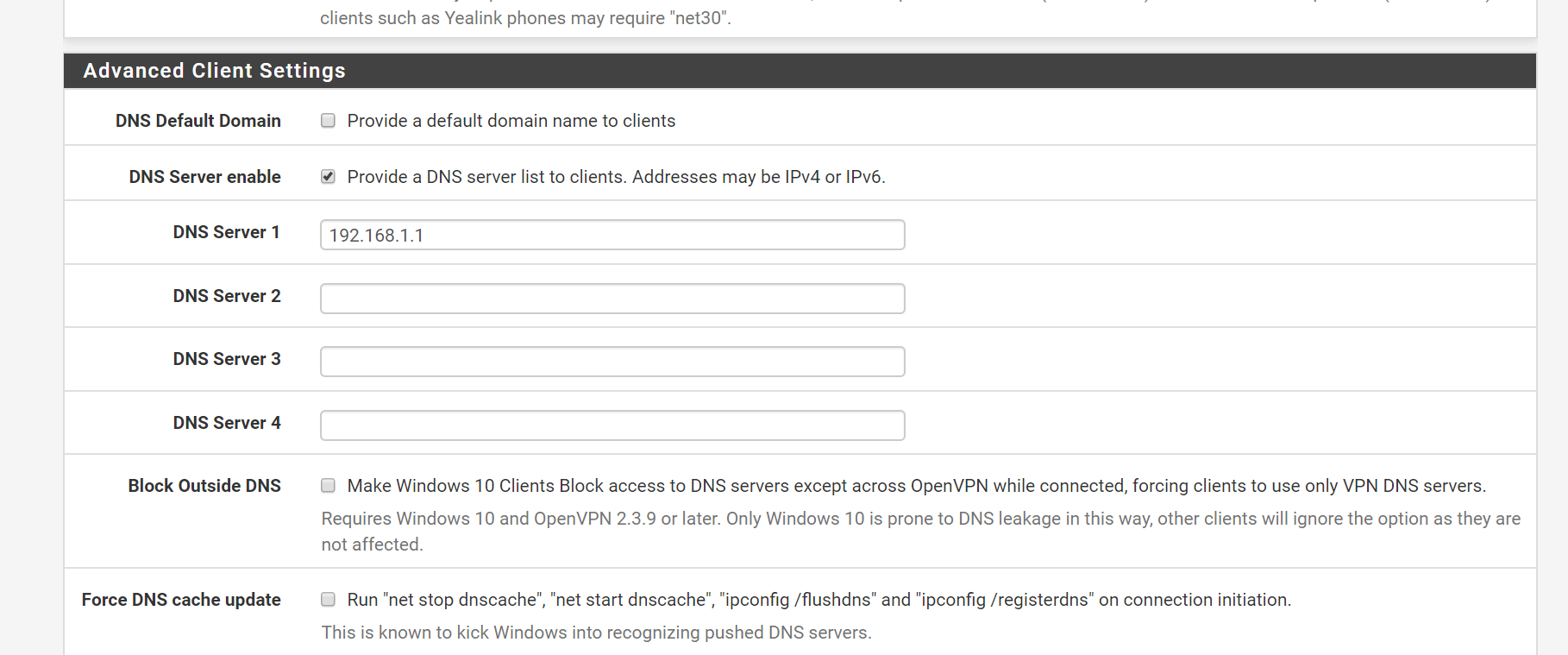

      Hello,
      I have OpenVPN setup on SG-3100 and I can go outside to the internet. When connected remotely when I try to ping computer using just the hostname ie. computer1 I get no response but if I try using computer1.mydomain.net I get response.
      If I'm at home and not connected via OpenVPN I can ping either using computer1.mydomain.net or just computer1.
      I have DNS Server set to pfSense IP. I've looked at other settings but could not find anything that would prevent me from being able to access it using just the hostname.
      Any suggestions?

        Notice on your vpn setting, you not setting a default domain...Which normally would be search suffix used when you just use a hostname vs a valid fqdn.

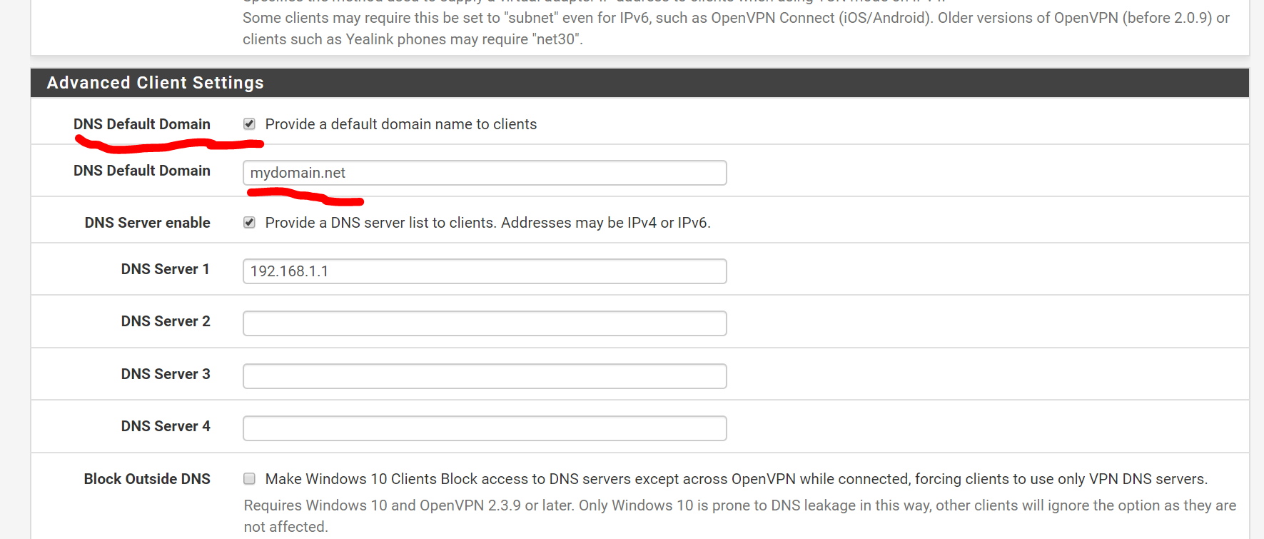

          Thanks for the examples and pointing about default domain!
          After I added mydomain.net I was able to ping it and I think that's what I was missing. Below is the screenshot in case someone runs into same issue.
