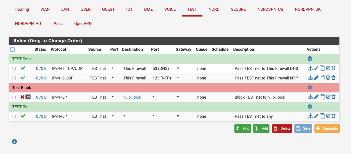

        n_ip_local is an alias with all my subnets in.
        Andy
          akuma1x
          Since you’ve got an “allow OPT to any” rule on OPT, that’s where the traffic is getting thru. Right above that rule you need to create a block rule for OPT to LAN.

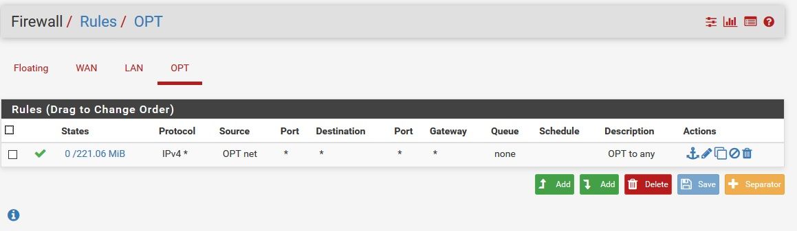

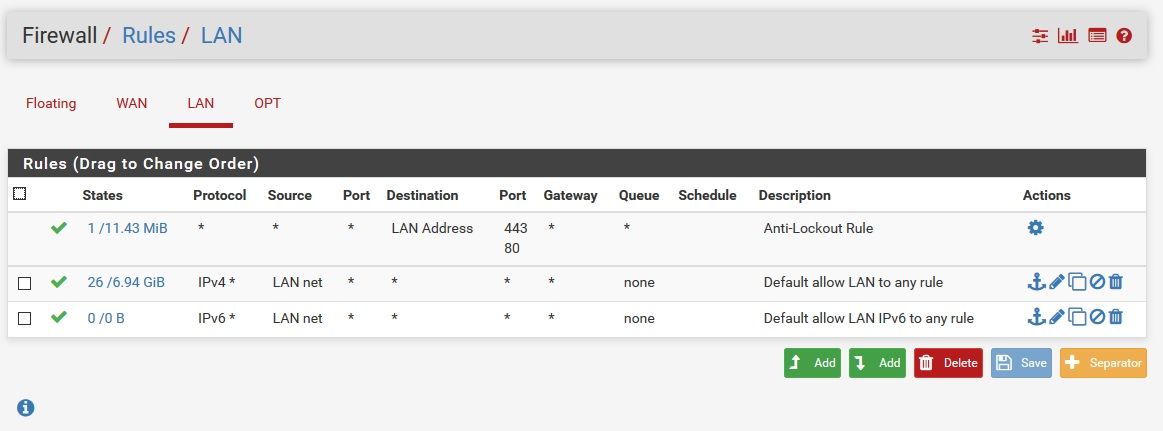

                willm
                Default rules on LAN, only the one rule on OPT. A device on LAN is unable to ping a device on OPT. A device on OPT can ping a device on LAN.
                Lan:
                Opt:
