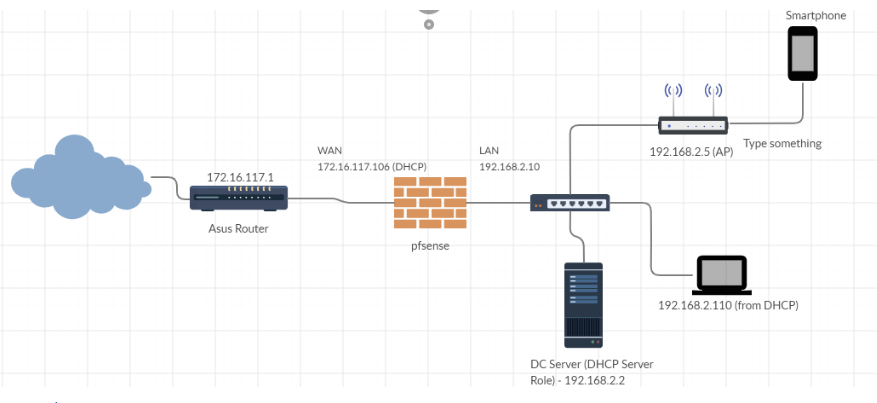

      Hello guys,
      I have this topology on my network :
      I have a static route on Asus router for network 192.168.2.0/24.
      So, I have Internet constantly dropping for 22-25 seconds every now and then (at least 20 times a day). I searched the Internet for this problem and I've read that if we have at least one static route on the network, I have to check the "Bypass firewall rules for traffic on the same interface" option on Sys > Adv > Firewall and NAT.
      From the time I checked this option, the Internet is faster and I have no disconnections from the Internet for at least 10 hours. My questions are :
      1. Is it right to enable this option? Is it safe?
      2. Is there any other way I can find the reason why I had the Internet disconnections (not LAN!) from pfsense logging?
      Thank you guys so much.

              Yes I know the consequences.. I disabled NAT on pfsense, its working as a Firewall only.
              Can anyone please help me on the problem? I have zero disconnections from the time I changed the option on the Advanced Firewall Settings. But, am I safe?
              Update : I just had a 11 second disconnection again. Sure I have way less disconnections from the time I changed the "Static Route Filtering" option.
