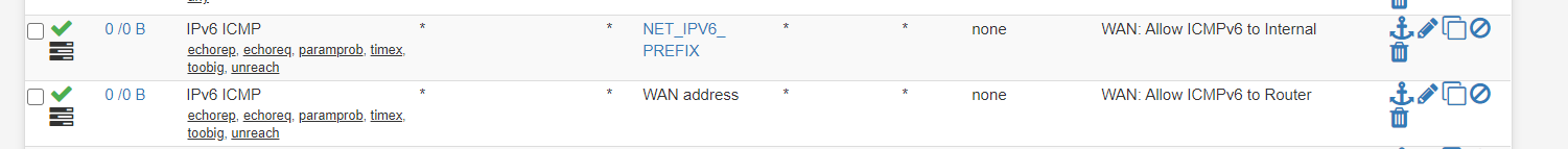

    LAN Net is fine as long as that is the only subnet you have. I created an Alias for my whole /56 i received from my ISP and these are the rules I have:
    This was based on "RFC 4890 Recommendations for Filtering ICMPv6 Messages in Firewalls" paragraph 4.3.1. Traffic That Must Not Be Dropped.
    I had not considered what @jimp said, that the pfsense takes care of some of these for you already.
    I don't remember why I added the WAN address rule, but maybe it was trace-route? Or just so I could ping the router externally and see it was up?
    The WAN address is an address external from my /56.
