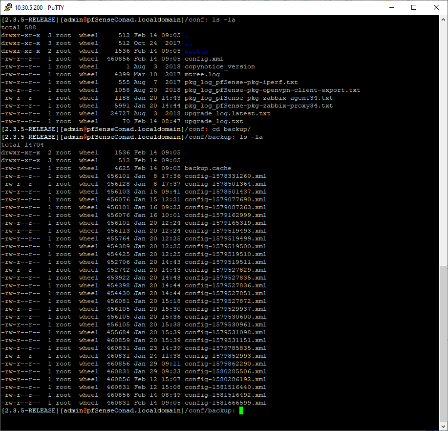

                              albgen @jimp
                              @jimp seems there is no config.xml.bad
                              • jimpJ Offline
                                Back then it might have been wiped out automatically. The error was from two days ago in your screenshot, though. I'd still say it was a failed attempt to change a setting to something with an international character.
