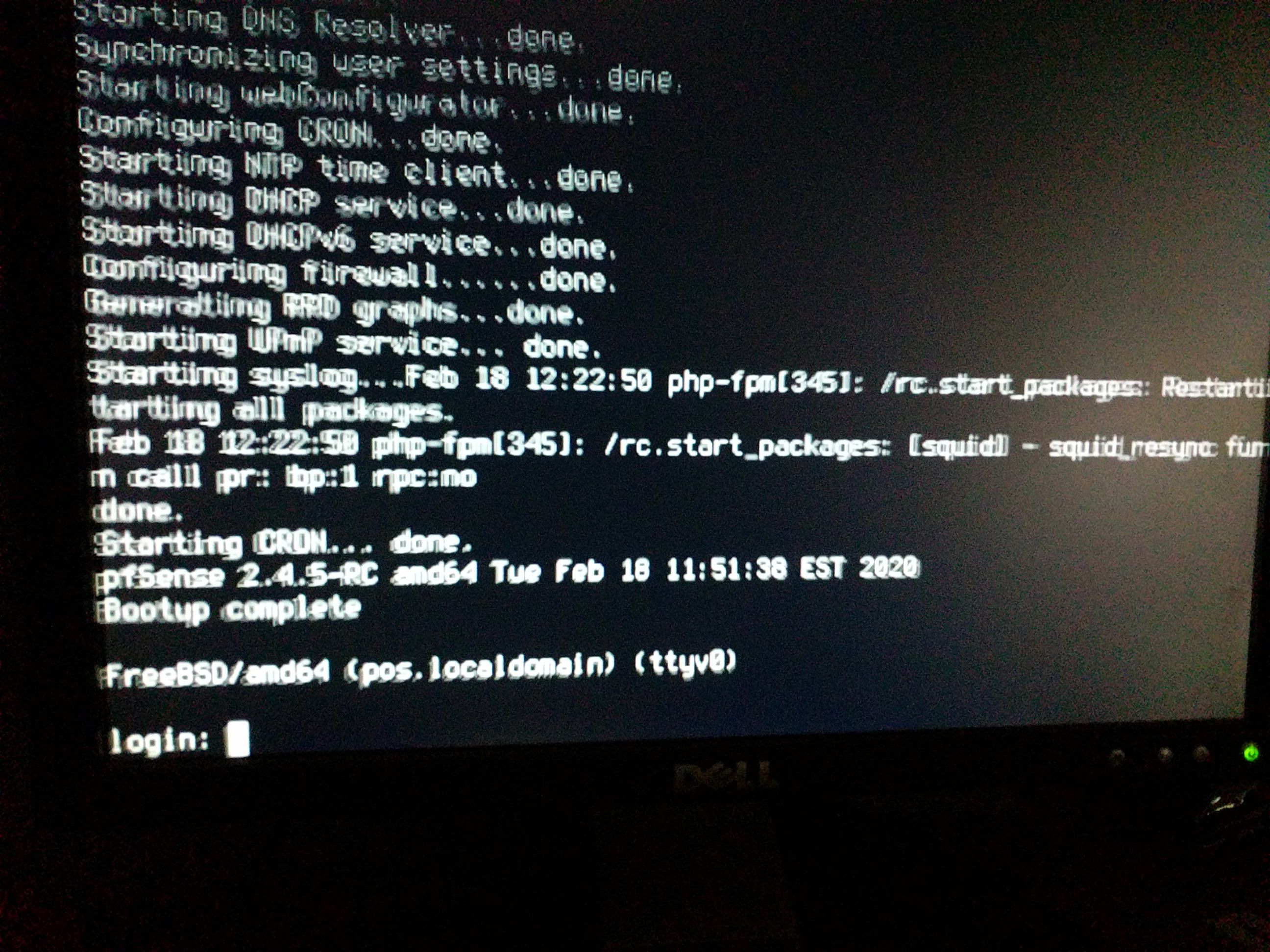

I have the issue with the squid

      @Grapeape22 i think you could use some inspiration for your artwork
      this might be a good place to start: https://www.asciiart.eu/
      G 1 Reply Last reply Feb 18, 2020, 10:19 PM Reply Quote 0
      • G
        Grapeape22 @heper
        @heper that was not supposed to be art my camera on my cell phone malfunction and I didn't realized at that time. It kind of does look like art lol

          Soo...
          php-fpm[345]: /rc.start_packages: [squid] - squid_resync ???? call pr: bp:1 rpc:no
          Is squid working afterward?
          If no, can it manually start with or without the webconfigurator?
          How is this development related? (from what I can tell nobody has touched squid for a while in the commits)

            @skogs said in I have the issue with the squid:
            Is squid working afterward yes
            is start this error when i did the last update i thought whole point of tester pfsense 2.4.5-RC to report error
            you dont need to be rude and disrespectful

              I'm not trying to be disrespectful friend, just you didn't mention whether it was running or functional afterward, nor an actual complete error line so hard to start troubleshooting. :)
              Finding out if it starts properly from the webconfigurator after full up compared to at startup can potentially be a valid troubleshooting step that would lead to the cause.
              edit:
              Just built fresh 2.4.4_release-p3 vm and installed full squid package. As far as I can tell, every single edit to the squid configs generates a similar line in the logs. Restarting the machine also puts one in the log every single time. Tested the blocking function with the clam functions and with another vm successfully blocked the eicar test file...
              While I cannot confirm or deny that the line is or is not an error, I think I can confirm that it existed before the 2.4.5 development freeze and that it has zero impact on functionality and probably not a blocker.
              edit#2:
              To clarify OP and my ???? in response the actual log line from normal config edits:
              php-fpm 766             /pkg_edit.php: [squid] - squid_resync function call pr: bp: rpc:no
              and
              php-fpm 767             /pkg_edit.php: [squid] - squid_resync function call pr: bp: rpc:no
              Actual log line from normal bootup:
              php-fpm 339             /rc.start_packages: [squid] - squid_resync function call pr: bp: rpc:no
