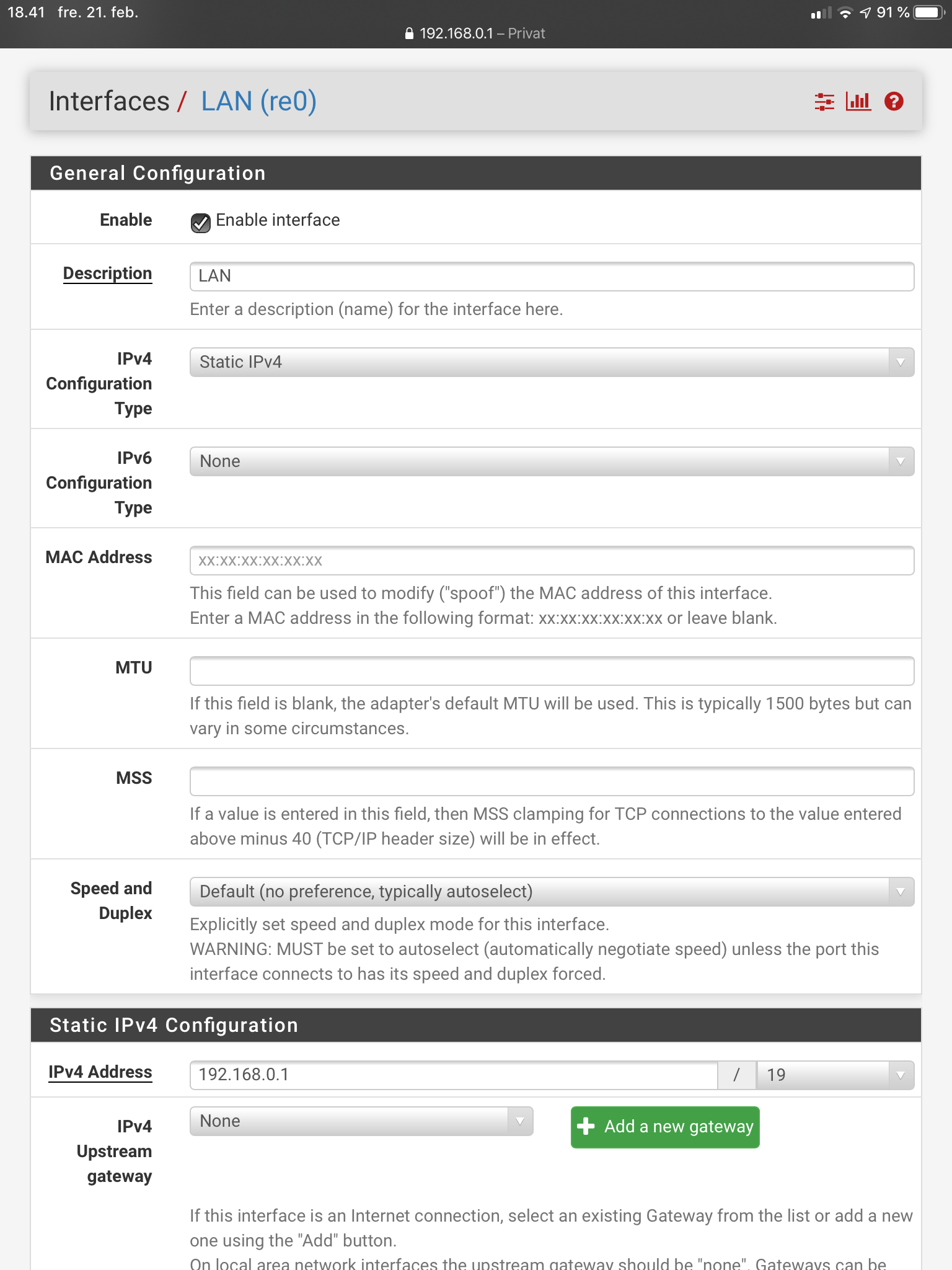

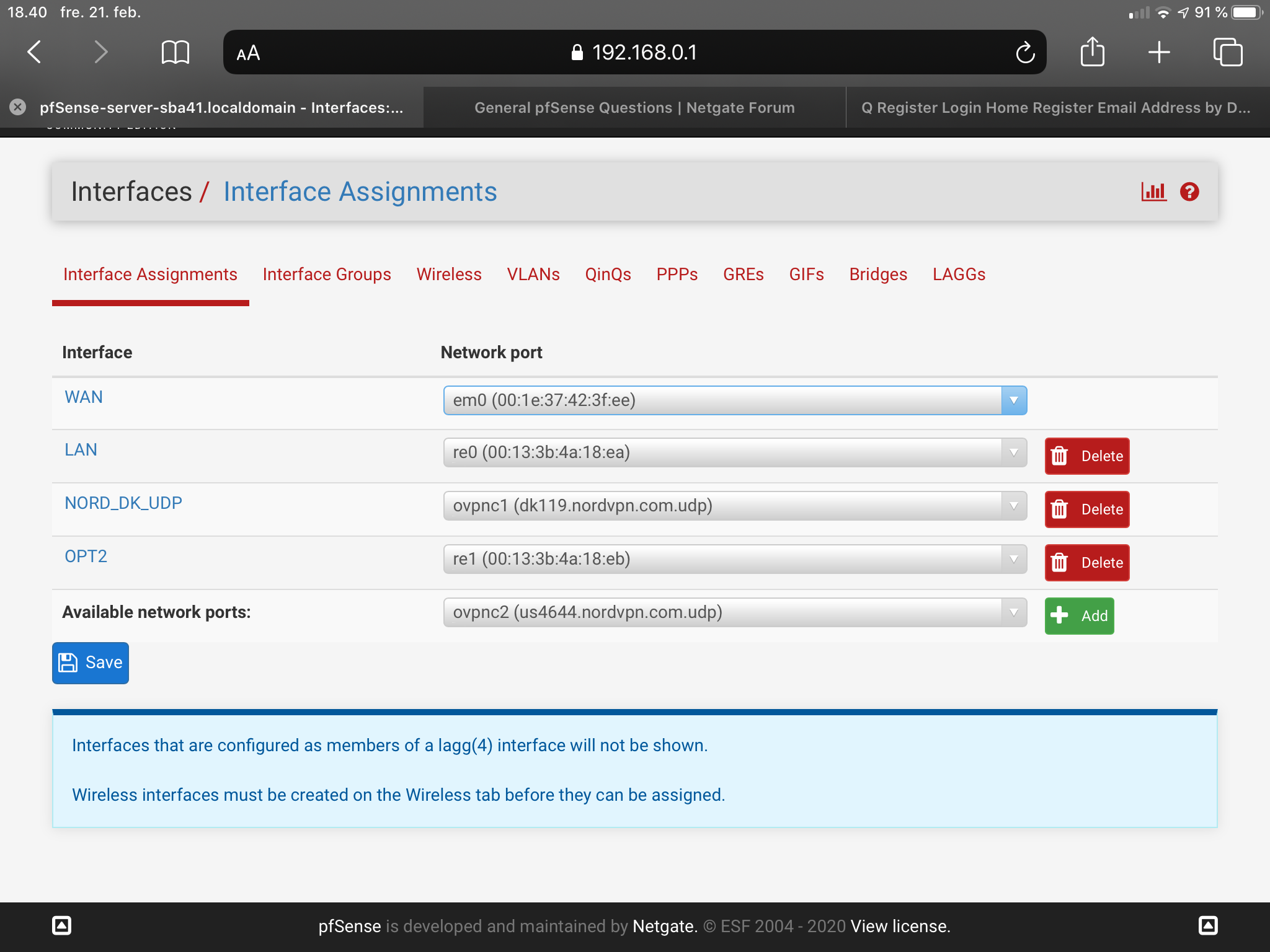

      How to setup 2 dhcp server 1 on interface lan and 1 on interface opt2
      Wan to lan
      Wan to opt2
      I hav 3 ethernet port on computer i run pfsense

        you need to set static on OPT2 also with a different subnet
        if you have LAN on 192.168.0.1
        you put static ip 192.168.1.1 on OPT2 for example
        the dhcp server is configured under Services / DHCP server

          Now i opt2 on statis 192.168.50.0 / 32
          And lan on static 192.168.0.0 / 16

                  should it also be / 32 or / 24 on lan also as I have set opt2 to 192.168.50.0/32
                  and my lan run 192.168.0.0/19

                        @thebonden said in Dhcp server 2 defrent interface:
                        Why in the world would you be using a /19?? Why?? Do you have some 8k devices on this network?
                          stephenw10 Netgate Administrator @kiokoman
                          @kiokoman said in Dhcp server 2 defrent interface:
                          use 24 everywhere and you will have no problems
                          This. 👆
                          Unless you have some good reason to use a subnet other than /24 then just use /24.
                            Wanting to use all of rfc1918 space because its available is not a good reason ;) for example..
                            I would really like to understand how you came to use /19 - is that your favorite number or something?
