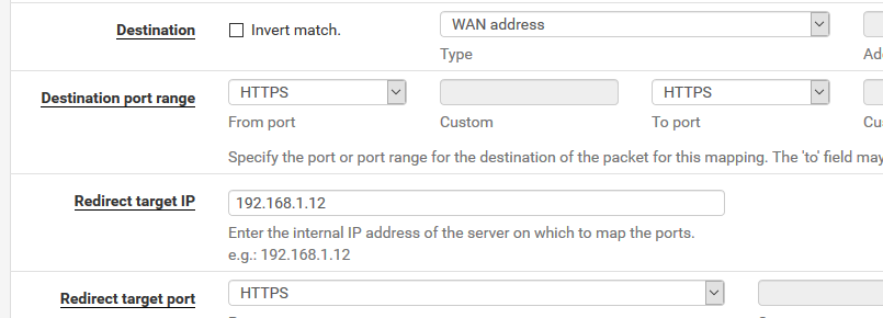

                      you may be overthinking it...here is a NAT entry sending 443 (HTTPS) to LAN IP 192.168.1.12:
                      For your purpose change the "destination port range" to Other and enter the port. Usually one entry per port but you could use from 7080 to 7081 in your case since they are sequential, with the destination port of 7080.
