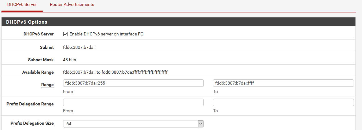

      Hi, I'm trying to build an IPv6 ULA environment, but I'm having issues in understanding some of the basics.
      I used https://cd34.com/rfc4193/ to generate a IPv6 address on my LAN interface. I assigned LAN the following v6 IP: fdd6:3807:b7da::15 the v4 IP is 192.8.192.15 so I tried to keep the same numbering so to speak.
      It's static IPv6 address - fdd6:3807:b7da::15/48
      I took care of disabling the "block private network option"
      I enabled the DHCPv6 and the RA deamon, because I have SLAAC and stateful clients in my LAN. I took a blind guess in creating the range:
      And I'm sending the RA as managed per choice:

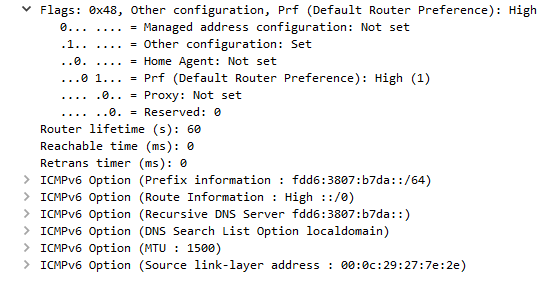

      Content of the RA:
      615be958-a65d-41b2-a418-26abb5f70a04-image.png aa77d695-35fb-4911-b979-4602c8dd0ba2-image.png
      Judging by the ip 6 routing table my RA is not taken into account as the default route. Is there something I must change on my RA or on my device ? (centos 7.6)?
