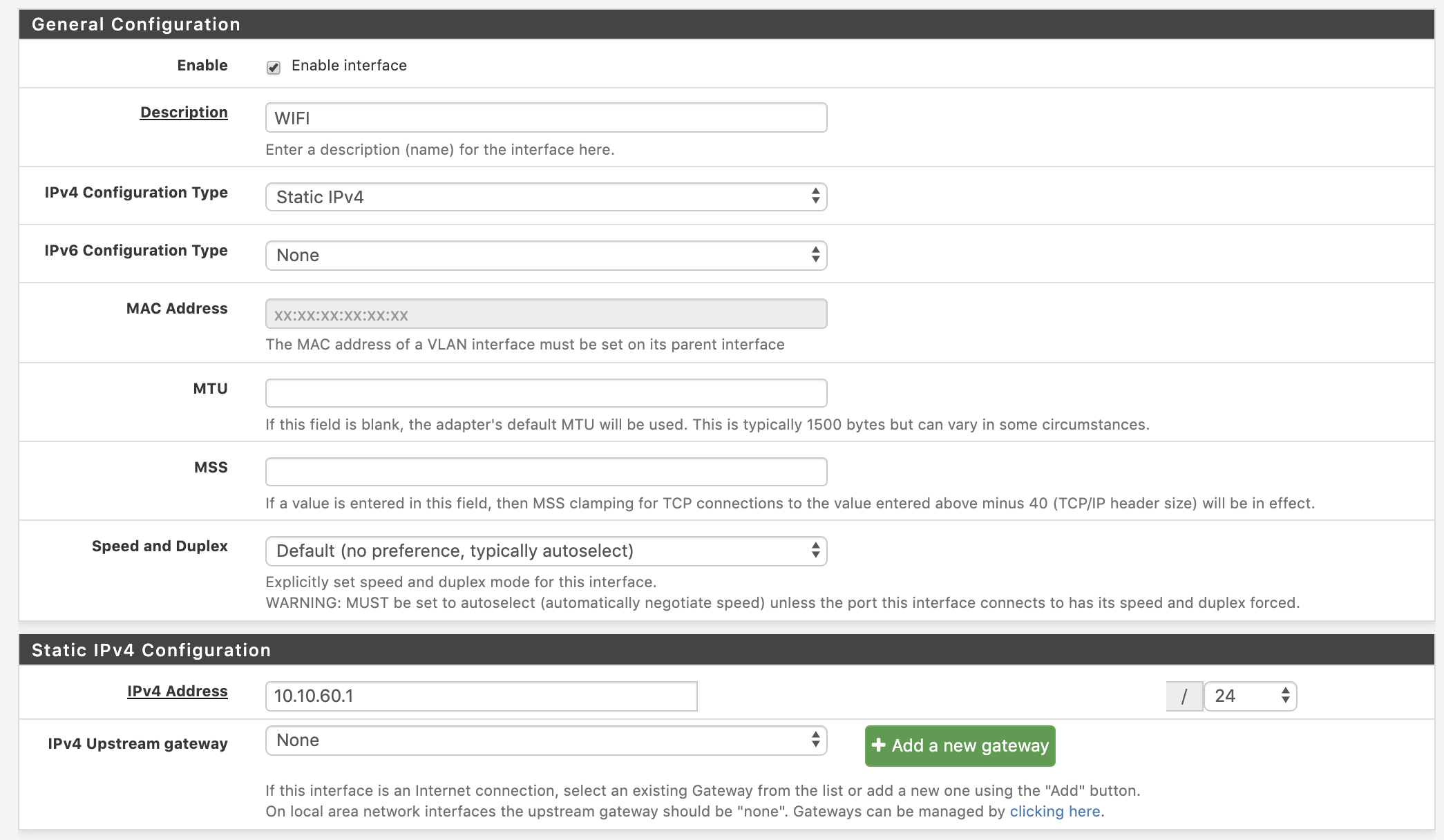

      There is no crazy FW rules on the LAN interface:
      LAN interface has a static IP range 10.10.60.1/24 with DHCP for the connected clients:
