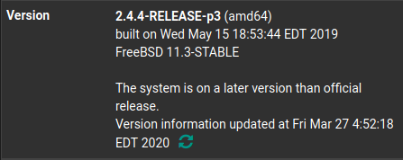

              SeaMonkey
              System went into a bit of a loop and eventually booted up. dhcpd and sshd won't start, but everything else appears to be working. I'm afraid to reboot or do anything from here.

                Gertjan
                and
                2.4.5 was build yesterday, 2.4.4 is from last year.
                If you were flying a plain, it would be time to declare a Mayday ...
                But this is pfSense, and you're probably dealing with a partial upgrade/update thing.
                No big deal, nothing that can be sorted out in a couple of minutes.
                Have look at the manual, to learn how to force a manual system package update.
                Or : save your config, and do a clean install.

                  SeaMonkey
                  Checked the manual
                  https://docs.netgate.com/pfsense/en/latest/install/upgrade-troubleshooting.html
                  ran
                  pkg-static update -f
                  It returned a warning saying a newer version of cpustats existed. I chose ignore warning and continue.
                  Then I attempted to run
                  pfSense-upgrade -d -c
                  It returned the same PHP error above.

                              • nzkiwi68N Offline
                                nzkiwi68 @Gertjan
                                @Gertjan said in 2.4.5 Update:
                                and
                                I had the exact same issue on a clustered pair of SG-5100.
                                The backup firewall upgraded from 2.4.4-p3 to 2.4.5 fine, but, when I then came to upgrade the primary firewall, it too complained "The system is on a alter version than the official release" and that makes no sense. It's only ever been on 2.4.4-p3 and earler releases, never pre release or beta, so I have no idea how it suddenly decided that.
                                Using putty and SSH, I ran these three commands in order to upgrade the problem pfSense;
                                • pkg-static clean -ay
                                • pkg-static install -fy pkg pfSense-repo pfSense-upgrade
                                • pkg-static upgrade -f
                                That fixed it completely.
