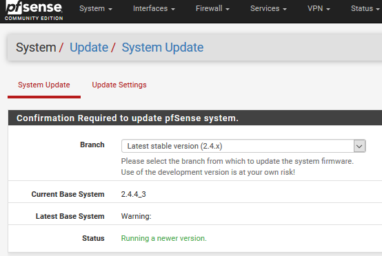

      I have been upgrading for awhile now from many different major and minor versions successfully. Now however I had an issue were a crash/bug was reported below is a link to the uploaded file:
      [0_1585416738242_PHP_errors.log](Uploading 100%)
      Next in the version page it says: Running a newer version.
      So my current version is newer than 2.4.4-p3 but indeterminate.
      Note I did not uninstall all the packages before the upgrade. Using quite a few.
      What would be the best course of actions?

      Update:
      I have since uninstalled all the packages and I performed a command line upgrade but I still get this the message on the update screen:
      Any ideas other that re-installing 2.4.4_3 and restoring the configuration from backup?
      And yes I still get the same errors
