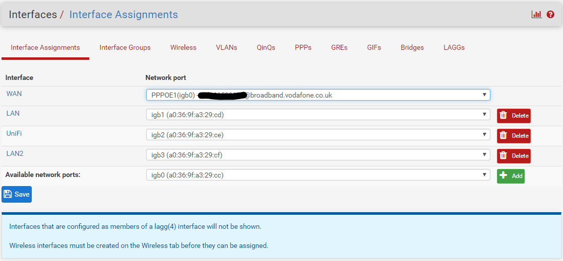

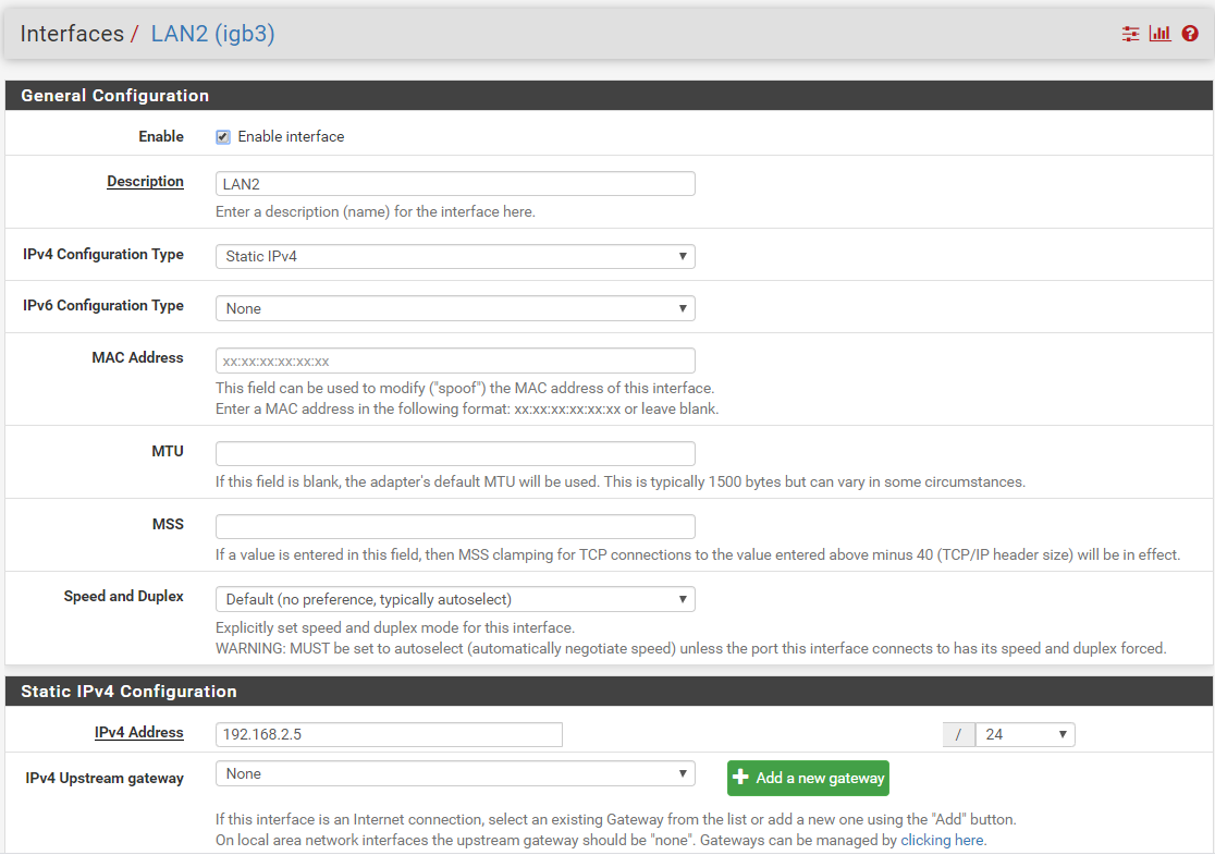

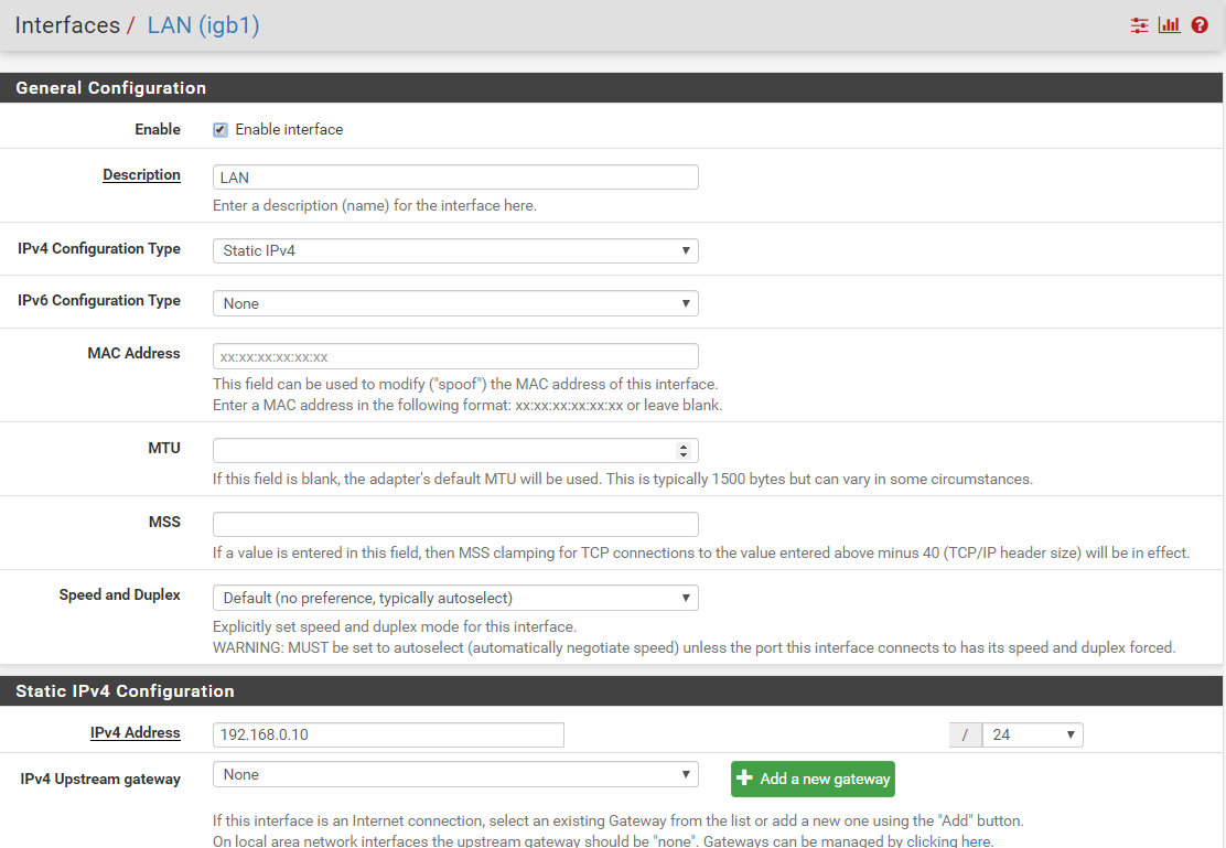

      I have pfsense running as a VM on an unraid server
      I have a 4 port nic with the following interfaces.
      I can ping anything from LAN to UniFi and vica versa but am not able to access some addresses on LAN2
      For example if I ping 192.168.2.55 from a VM on LAN2 I get a response and can access the device but if I repeat from LAN or UniFi I cannot reach it.
      But if I ping another device 192.168.2.57 from LAN or UniFi I can reach it without issue.
      I have several devices I can reach and several I cannot

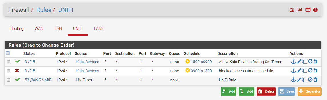

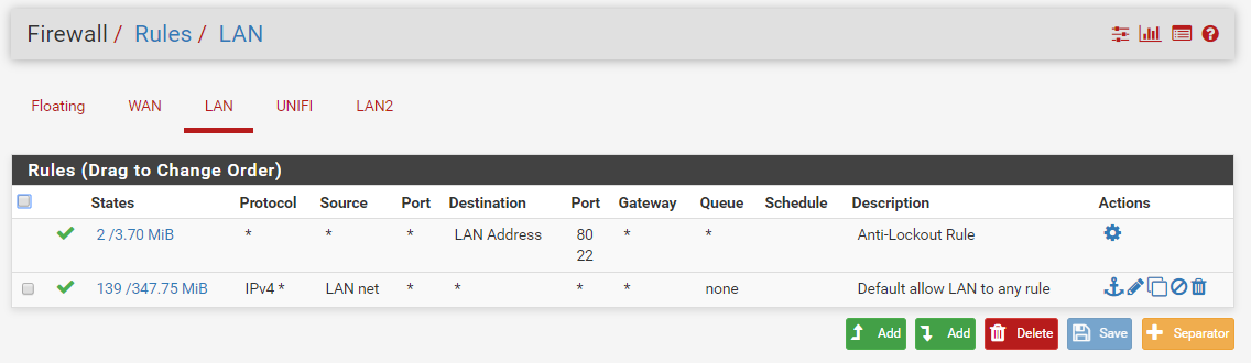

      As far as I can tell my rules are correct so can anyone please help as to why this is happening?
      Thank you

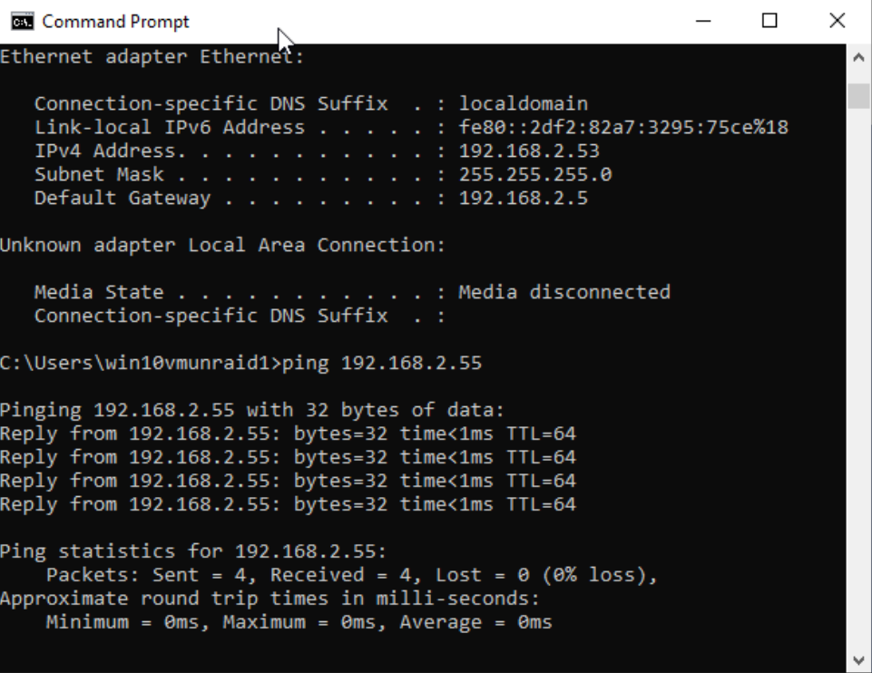

              mbc0
              Obviously I can ping from the same network, this was just a screenshot to prove the device existed.

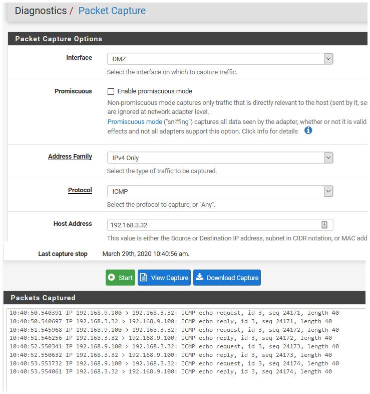

                Dude why would you do all when what your interested is in ping? And it defaults to only capturing 100 packets.. So no shit you prob finished your capture before you even ran your ping - so that is why don't see anything..
                Look at your sniff, that is what 100 packets in less than 0.2 seconds.. Really dude come on!!!
                Set the capture to be the dest IP your interested in, and just ICMP...
