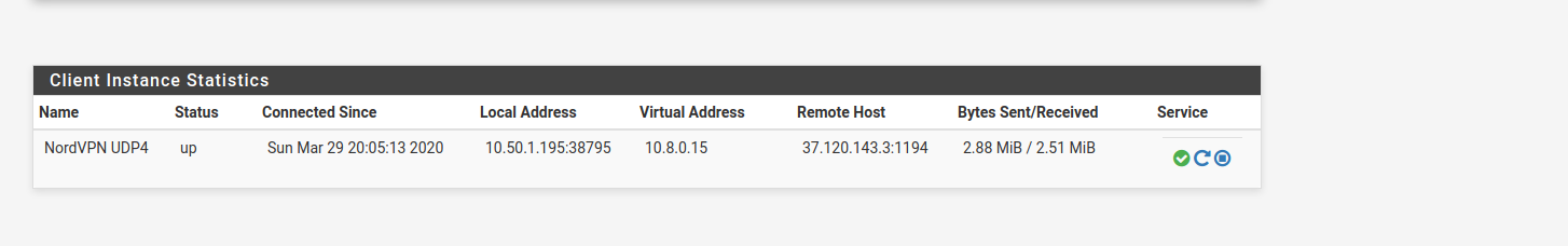

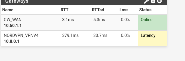

      I have setup my NordVPN via OpenVPN however its status either on Latency or Offline. I have tried couple different server of theirs but result is the same. I have tried those servers with OpenVPN client on my laptop and they are just fine so there must be misconfig somewhere either on their guide or in my setup.
      anybody had this issue with nordvpn openvpn?

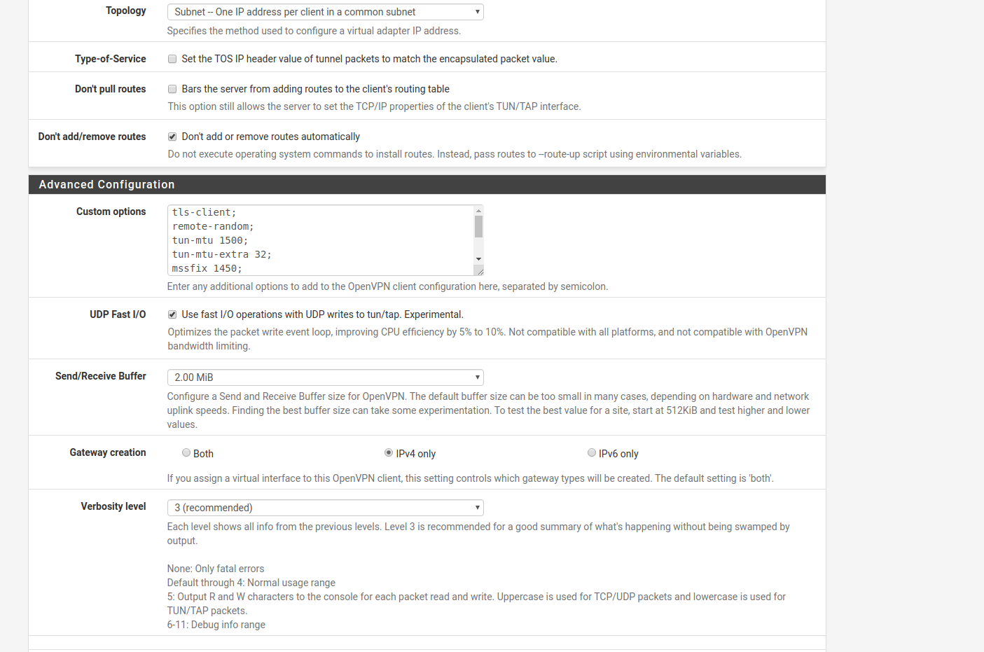

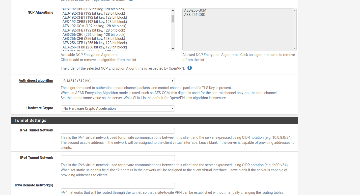

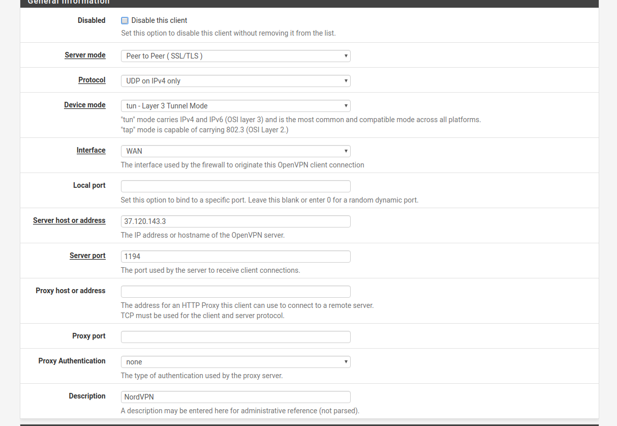

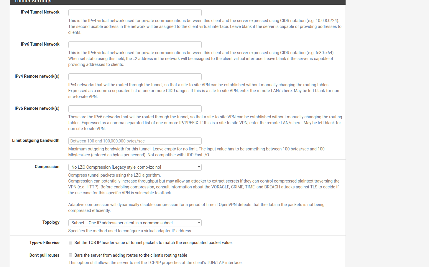

            @md2406 Best would be everything on the openvpn client page.

              Screenshot from 2020-03-29 23-15-36.png Screenshot from 2020-03-29 23-15-57.pngScreenshot from 2020-03-29 23-22-17.png

                        @md2406 Don't use fast I/O, almost at the end. (UDP Fast I/O)
                          md2406 @Bob.Dig
                          @Bob-Dig I tired both unchecked and check for that option, the result was the same.
                          • Bob.DigB Offline
                            Bob.Dig LAYER 8 @md2406
                            @md2406 Not for me.
