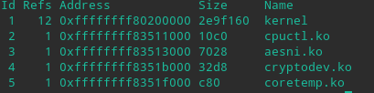

      kldstat output:
      Also when I try to load it manually i get the following from kldload:
      dmesg relevant output:
      ASFAIK this means the version of my FreeBSD is not the same as pfSense one.
      What version of FreeBSD should I use in order to be able to be on the same version, in order to compile ?
