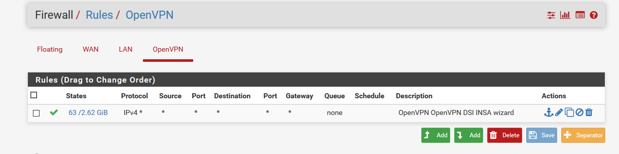

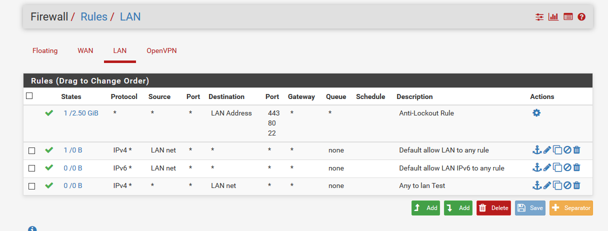

Show your OpenVPN setting and Firewall Rules via screenshots.
-Rico
The Firewall "OpenVPN" tab matters most because your have problems with incoming traffic there, right?
-Rico
Just default on that tab :

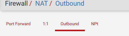

Outbound is set to Hybrid Outbound NAT already.
