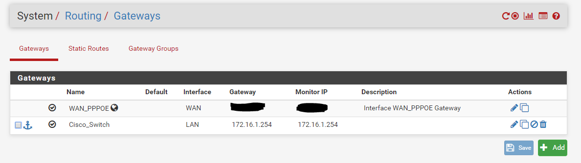

              What does traceroute show? Also, why are you hiding the monitor IP? That shouldn't be your assigned address. It could be your ISPs gateway, DNS server or some other publicly reachable address.

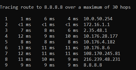

                  This is traceroute from vlan 50
                  Hiding it comes to me automatically :) this is lab enviroment and WAN IP is assigned by ISP dhcp, no reason at all for hiding. I fell sorry if you interpreted as a lack of trust.

                    @chiprule said in DNS doesn't work after switch layer 3 inter vlan routing upgrade:
                    I thought your problem was reaching VLAN 50. Why are you showing a traceroute from it to the Internet?

                      • C
                        chiprule
                        Hi @JKnott
                        As I said in first post
                        "Now i can ping from vlan 1 to vlan 50 and viceversa.
                        I can ping PFsense LAN IP interfaces from both vlan.
                        I can ping 8.8.8.8 from both vlan.
                        I can go in internet with vlan 1 but not with vlan 50."
                        "It seem to be a DNS problem. I can't figure out what is the missing or wrong config."
