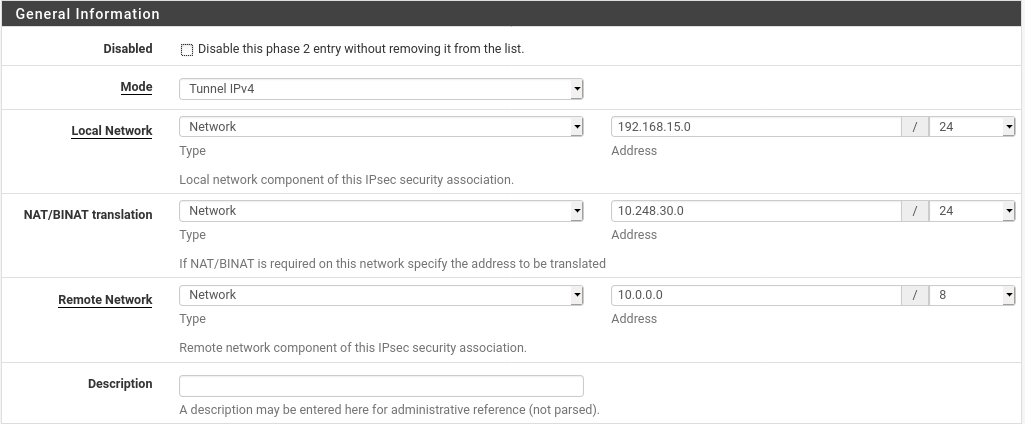

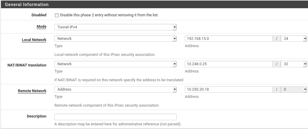

          I have the split connections box checked. Remote side has x8 P2's to our side which has x1 NAT'd IP
          Tunnel will come up with all x8 P2's up and working... after a period of time one or two or three will disappear and will not show in IPSEC status as a child that is down.
