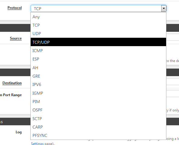

        A firewall rule can be set to TCP, UDP, or both.
        A port has no notion of the protocol being used.
        So : "User-A" (TCP/UDP) firewall rule with "User-A" Port Alias.
