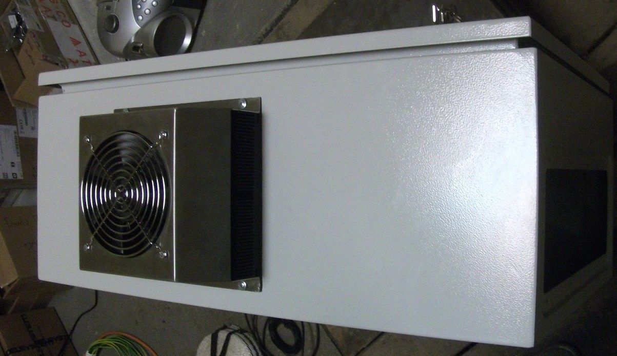

                  • DaddyGoD Offline
                    DaddyGo
                    We choose the solutions shown in the pictures if the installation cannot be solved only in extreme environmental conditions.
                    This is a good price available TEC (thermoelectric cooler - 300W)
                    Factory outdoor cabinets are terribly expensive!
                    The question is legitimate (from johnpoz) , why don't you take the firewall elsewhere? Not possible?

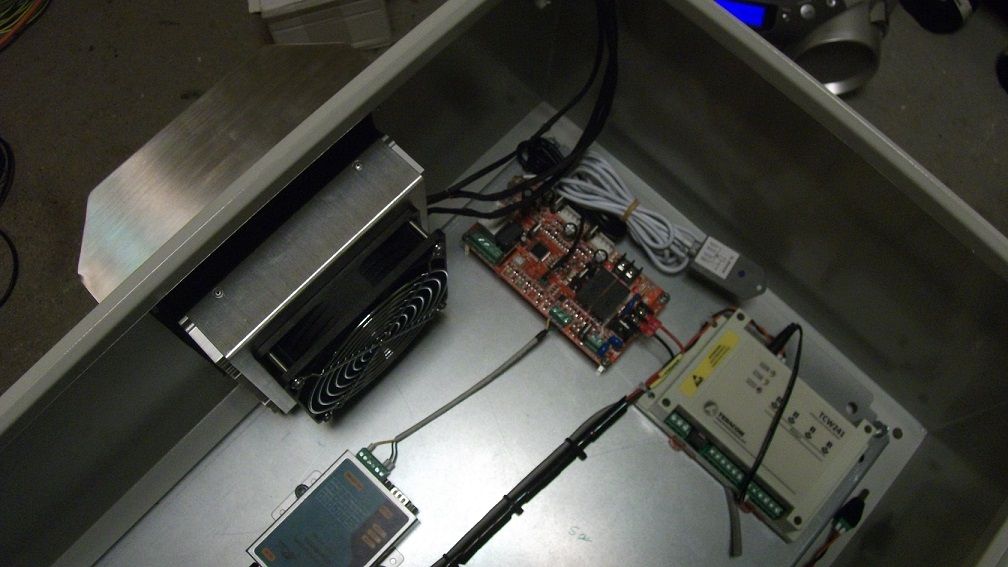

                    • DaddyGoD Offline
                      DaddyGo
