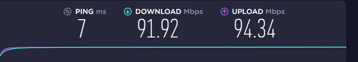

no i am getting 94 mb up and down

Very interesting and have a 94Mbits connection?

That indicates a 100 Mb connection. If that's all you're getting, then perhaps you should be talking to your ISP. In the mean time, that screen capture I asked for would help.

so the problem was a long cable between the ONT and the PF (20 m)
because when i connected it to a meter cable i got 1000 mb linestill now i get speed of 300mb but that is identical to the isp router and an asus a68 router
