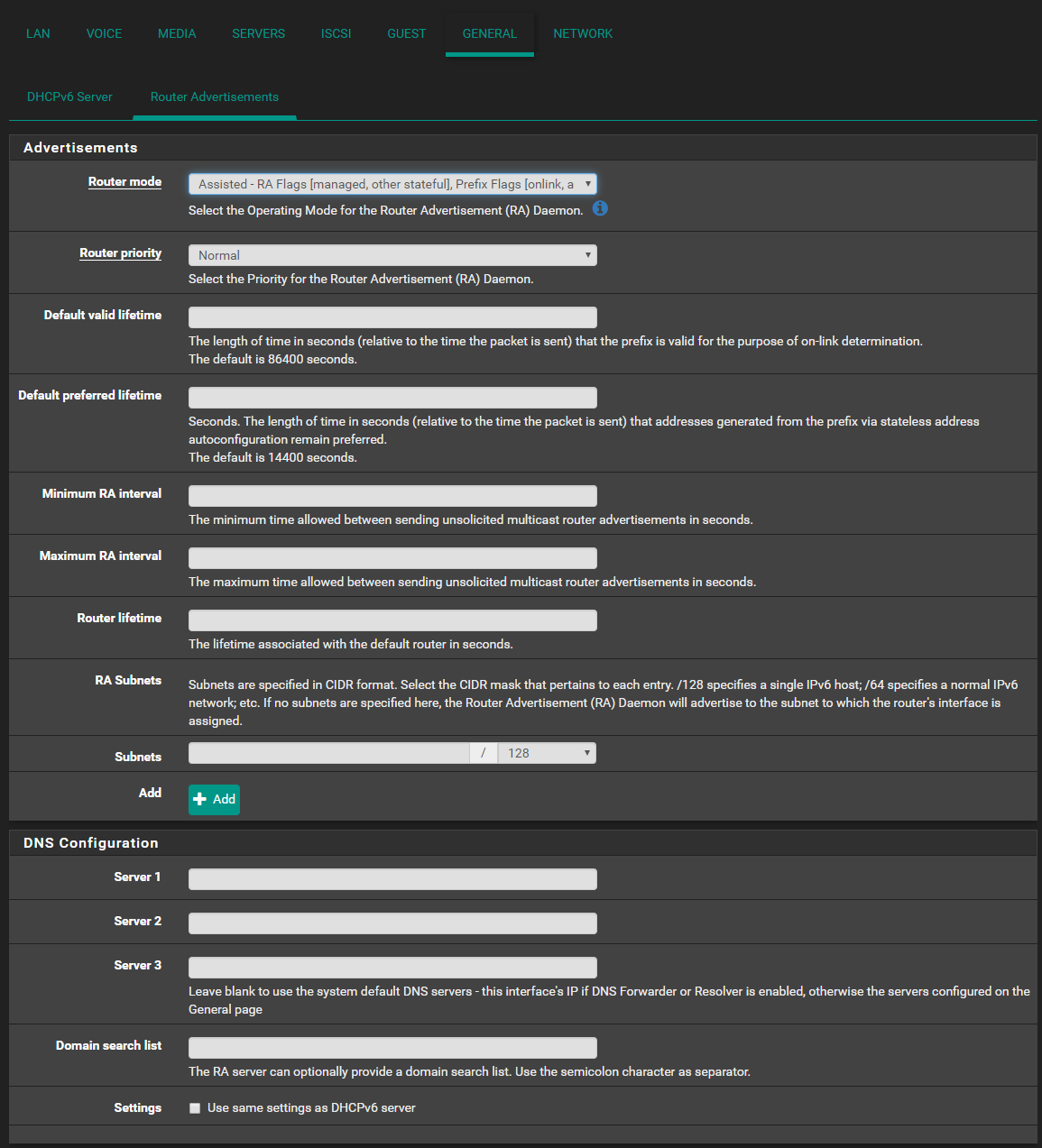

          Ok, let me summarize:

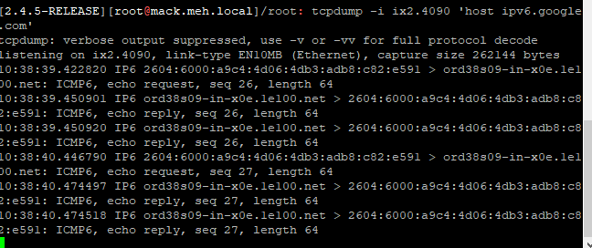

          If you'll look at the screenshot of the ping which is a tcpdump of the ipv6 traffic on my router, my router with a 2602: address sends an ICMP request out to google. Google replies twice and the packet gets back to the WAN interface on my router.
          However, if I run the same tcpdump on the general vlan interface on my router, I do not see the echo response.
          I included the firewall rules that are in play, and ipv6 should be allowed.
          This looks like an routing issue to me, but not sure (due to this being RA) how to diagnose that.
          Thanks.

            Yes, it could be a routing issue. Again, packet capture can help. When you examine the packets, do you see the correct addresses? Are there any firewall rules blocking? All RAs do is provide things like the gateway address, prefix, DNS, etc.. Again, examining the packets can tell you a lot.
            Also, please be precise in describing what you're doing. For example, when you run tcpdump on the LAN, I assume you're pinging from the LAN, but I can't be certain. Also, firewalls are generally used for things that originate outside of the firewall, so if pings are going out, the replies should be coming back without a specific rule to allow it, etc.. Also, on the rules you have General net for source. What does that mean? In looking at what you have, I'd say you've created a complex config that may be causing your problems. As always, start simple and go from there, so you have some idea what might have caused a failure.

                But it seems unlikely Google are replying twice in that packet capture. More likely the ping reply is being incorrectly routed back out of the WAN so you see it twice. If you view the pcap at full detail you will see the MAC addresses begin used so you can check that. Check the system routing if so.
