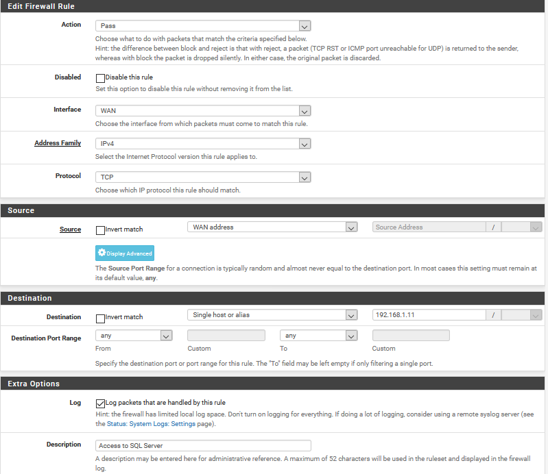

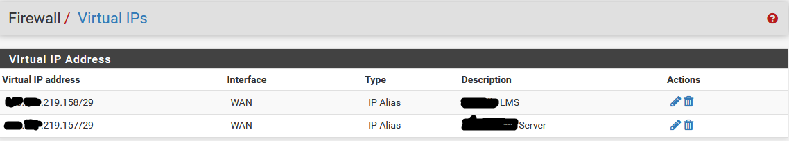

      My requirement is to create a HyperV Windows 10 VM with MS Sql Server which will be accessed by an certain application from both Intranet and Internet.
      PfSense FW - LAN IP - 192.168.1.254 / WAN IP - xxx.xxx.219.154
      I have 5 public ips from xxx.xxx.219.153 - xxx.xxx.219.158
      xxx.xxx.219.153 is the WAN gateway
      I have two virtual Servers
      • One web server which I have 1:1 NAT from xxx.xxx.219.158 >>>>192.168.1.10 through port 80 which is working fine.
      • Windows 10 VM with MS SQL Server which I'm trying to NAT from xxx.xxx.219.157 >>>>192.168.1.11 through port 1433 which is not working.
      • I can ping xxx.xxx.219.157 from both WAN and 192.168.1.11 from LAN.
      • I can telnet port 1433 from LAN side to the 192.168.1.11
      • But i cant telnet xxx.xxx.219.157 from WAN
      • I even tried by making the destination port any in the firewall rule.
        Because of this my application can't access the database from WAN side. It is only working from LAN side. I do not want to make the DB server facing internet directly.
      Really appreciate if you can advice me on this regard. (Screen shots are below)

        i can't ping but
        x.x.219.157:1433 port is open
        maybe check windows firewall
        your ip is on the cmd screenshot, you forgot to hide it
        check pfsense firewall log, you enabled packets log, you should see something there if it's passing or not
        also diagnostic / packet capture or wireshark could be useful
