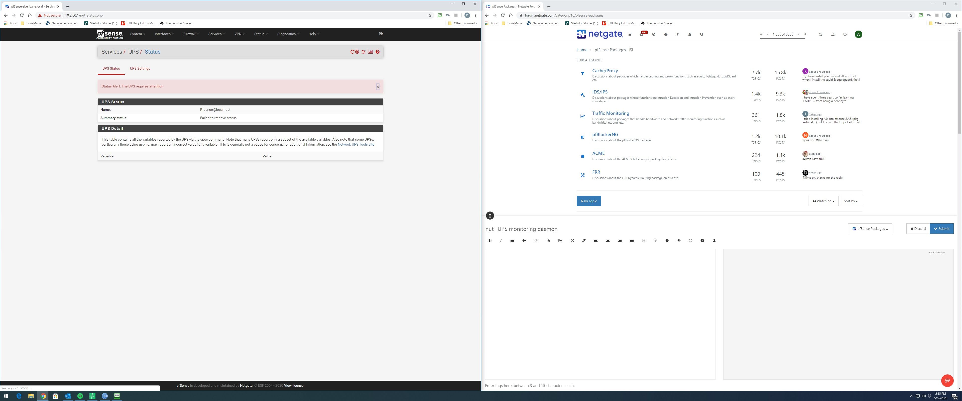

      Status Alert: The UPS requires attentionpfsense.jpg pfsense2.jpg The APC is a br1500ms back-ups pro. What can I try to get it to be recognized.
      Thanks

        @aadder Did you get this working? If not does the acpupsd program work? If you want to used nut for this then connect to the system using ssh and check the permissions on the usb device the ups is connected to. That would be in /dev/usb/ directory. The permissions should be crw-rw---- root uucp
