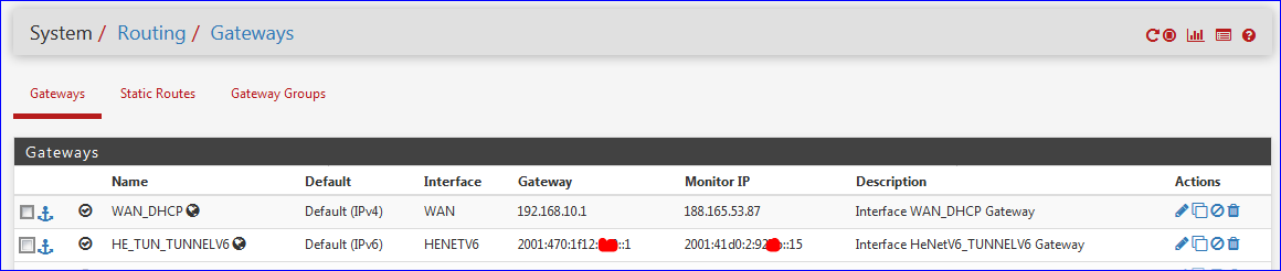

                        I do have a IPv6 access, not via my WAN ISP interface, but a separated interface, from he.net - some sort of "IPv6 over IPv4 tunnel" scheme that permits my pfSense to have a IPv4 over WAN and IPv6 over some other interface.
                        Works great.
                        Both are listed :
                        If my IPv6 is down or not activated, I have this impression that my outgoing IPv6 requests eventually fall back to IPv4.
