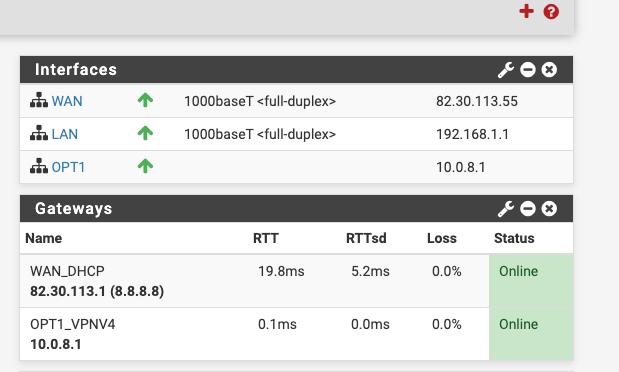

      2. Both LAN VPN and WAN gateways are reported as up (WAN gateway is pinging 8.8.8.8). LAN, WAN and VPN interfaces look okay :

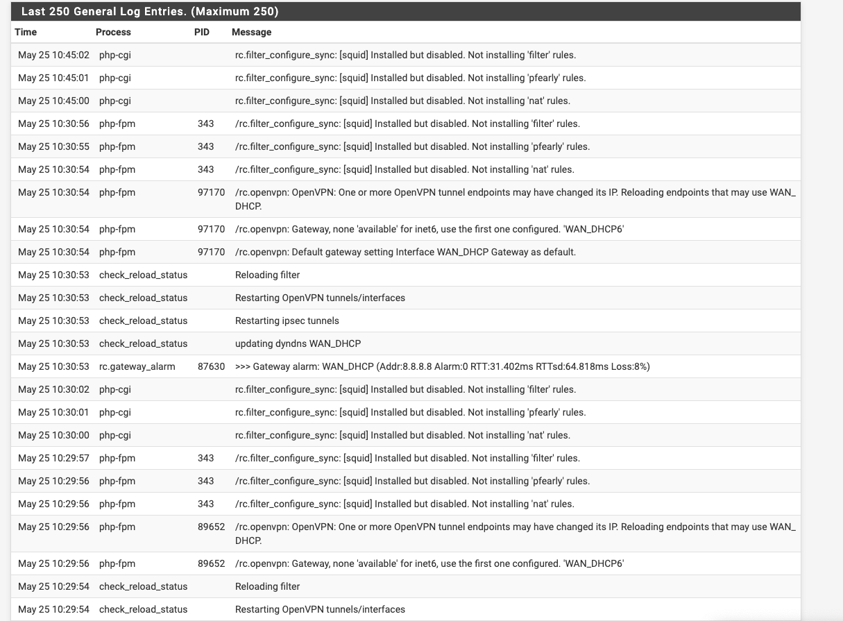

          Yes, using the Resolver. The resolver logs show configuration is reloaded every (approx) 5 to 15 minutes :
          May 25 10:45:04 filterdns merge_config: configuration reload
          But no service stop and restart.
          The setup is using FreeBSD 11.3 :
          I do see some similar filter reload activity in the system logs :
            @rrab said in Intermittent pfSense partial outage:
            Both LAN and WAN gateways are reported as up
            There shouldn't be a LAN gateway.. Are you saying you can ping it so you know its up? You don't set a gateway on LAN interfaces..
            Did you manually create a downstream gateway.. Is there some router downstream on your lan network? This wouldn't be set on the interface as a gateway.. And even if set up manually to get to a downstream router, this shouldn't be your LAN, that should be a transit network.. or you going to run into asymmetrical routing issues if devices are this LAN network.
              rrab
              Apologies, I mis-typed. I intended to say that both WAN and OpenVPN gateways report as online : and all interface report as okay.
                Filterdns would run when there is an update to aliases you have created.. They by default run every 5 minutes.. this would/should not effect unbound being able to resolve..
                What is more likely is your having an issue with your vpn.. And your trying to have unbound to use your vpn to resolve? This gateway might have gone down, or your IP changed and unbound is not bound to it..
                You can see log entry where your openvpn was restarted. Looks like you had a gateway alarm - why are you using 8.8.8.8 vs just your isp gateway to monitor?
                The best thing you can do if your wanting to resolve through a vpn, is run your resolver downstream of pfsense - so you can policy route the traffic.. Vs unbound running on pfsense having to bind to the vpn interface to be able to use it to resolve. Other option is on your outbound interface in unbound.. Set it to only use the localhost.. This way its queries will be routed via your routing... Pretty much all users setting up vpn services allow the vpn service to be default (uggghhh)..
