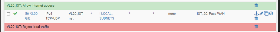

Here are the rules

So these 3 rules will never get hit by any traffic.This rule :
will get used by any traffic as long as the destination isn't "LOCAL_SUBNETS". (Dono what LOCAL_SUBNETS actually is)
I advise you to change "TCP/UDP" for "All" which includes, among others, ICMP.
Your iPad should be able to go 'outside'.To test, disable your first rule and check if you can reach the pfSEnse IP base VL20_IOT_address - if you can see the pfSense GUI, using your iPad and a browser.

LOCAL_SUBNETS is the 3 other networks I have,
10.0.10.x which is the device LAN
10.0.30.x which is internal device LAN
10.0.99.x Admin LAN
The rule is meant to stop the IOT devices from talking to the other networks but allow traffic to the internet. Which is working for some and not others. -
I would not craft rules like this.
I would reject to destination LOCAL_SUBNETS then pass to destination any.
You should probably packet capture the host that can't get out and see what it is doing and what is failing.
