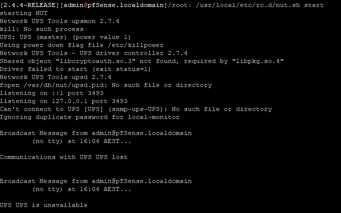

      I am having a problem configuring my UPS and the nut package.
      The UPS is an Eaton 5px with a Network-ms card. It is connected over ethernet.
      I set up the UPS settings as:
      UPS Type: remote snmp
      UPS Name: UPS
      Remote IP: ip address of UPS
      The service fails to start and I receive an error "Driver not connected"
      When I ssh in to pfSense and run the command /usr/local/etc/rc.d/nut.sh start, I get the following error
      How do I go about correcting this?
      Thanks!
      Edit: I uninstalled the nut package and updated to pfSense 2.4.5_p1.
      Then reinstalled both net-snmp and nut packages.
      Everything is working as it should now
