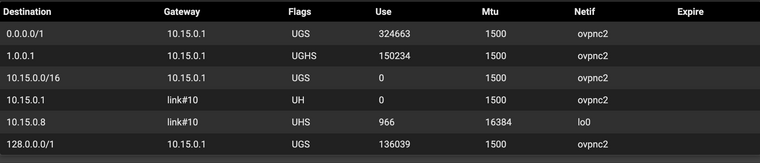

                        These are the local routes for the OpenVPN clients:
                        10.15.0.0/16
                        10.8.1.0/24
                        10.24.44.0/22
                        External all have IP_ADDRESS/32
                        I'm learning as I go. Does this have significance to my situation?Screen Shot 2020-06-10 at 8.14.25 PM.png Screen Shot 2020-06-10 at 8.15.33 PM.png Screen Shot 2020-06-10 at 8.16.02 PM.png
