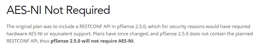

            The reason I went for Chinese single box was it seemed more powered than the official Netgate stuff with an i5 intel..
            Looking at a SG-3100 for example it doesn't seem to have AES-NI which I was led to believe was vital for future support. It also doesn't have much ram?.
            Is this not that important then?

                AES-Ni theme (future):
                A lot of colleagues run pfSense on older older hardware with 2 to 4 GB of RAM, so muscle strength is not always relevant
                I think for your purposes and to be able to learn, a SG-5100 is enough for the first time
