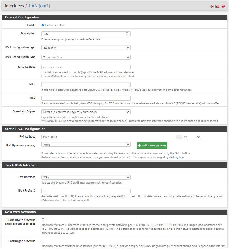

      LAN interface (em1)
      Able to ping -6 to various sites and reach IPv6 test sites
      General Config
      IPv6 Config Type Track Interface
      Track Ipv6 Interface
      IPv6 Interface WAN
      IPv6 Prefix ID 0

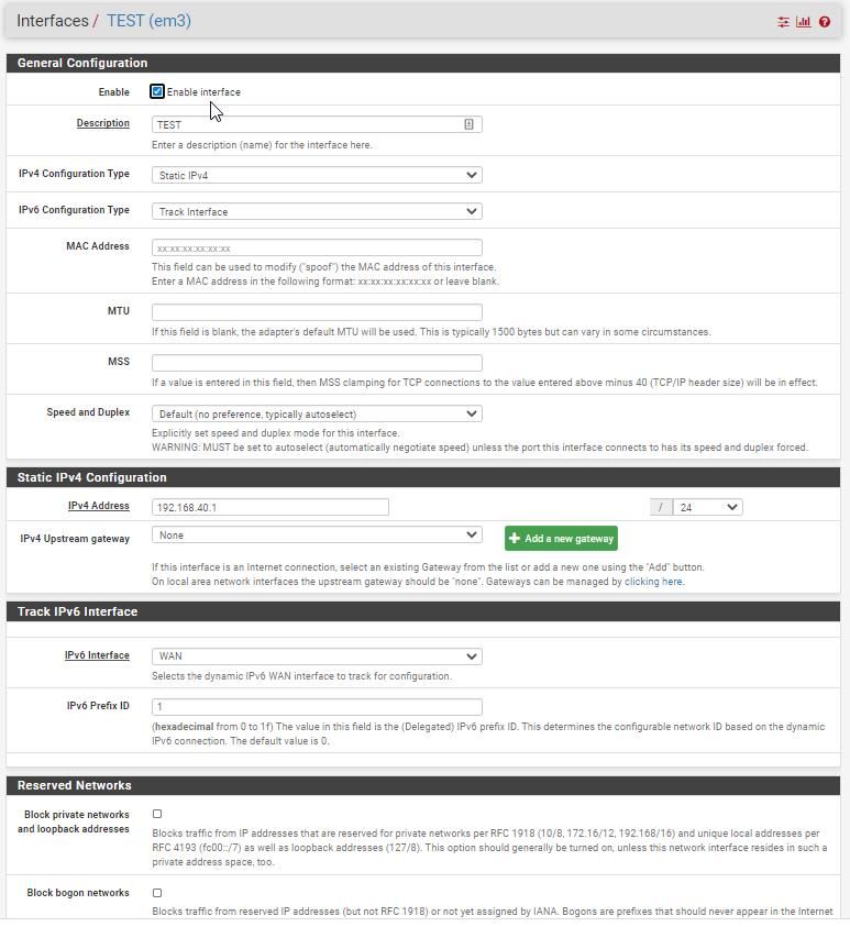

      TEST interface (em3)
      General Config
      IPv6 Interface WAN
      IPv6 Prefix ID 1

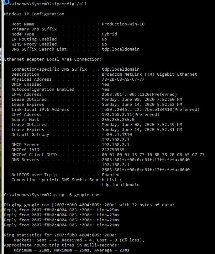

      I get IPv6 Address and Default Gateway on a PC on the TEST LAN
      ping -6 google.com results in
      Pinging google.com [appropriate IPv6 address] with 32 bytes
      Request timed out.

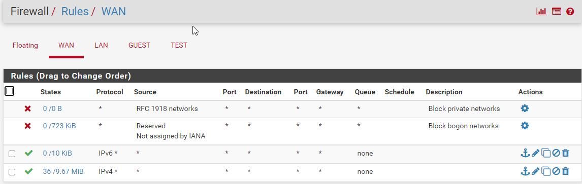

            Your WAN and LAN configuration settings. All I see are firewall rules.

              The configuration that I changed are in the text of the message. I can post images too.
              • T Offline
                tpalmer0127
                Configurations for WAN, LAN, TEST

                  Is that what your ISP is providing? The image for the WAN interface is a bit blurry, but it looks like you've selected 59. I have 56 for my ISP. Both 56 and 48 are common, though you can chose anything up to what your ISP provides. Also, you may want to select Send IPv6 prefix hint.
                  UniFi AC-Lite access point
                  • T Offline
                    tpalmer0127
                    Prefix size for WAN is set at 59. That was recommended in a post perhaps on this forum. I can try other size
                    • T Offline
                      tpalmer0127
                      Changed to 56 and IPv6 works on the TEST lan.
                      Thanks for the help
