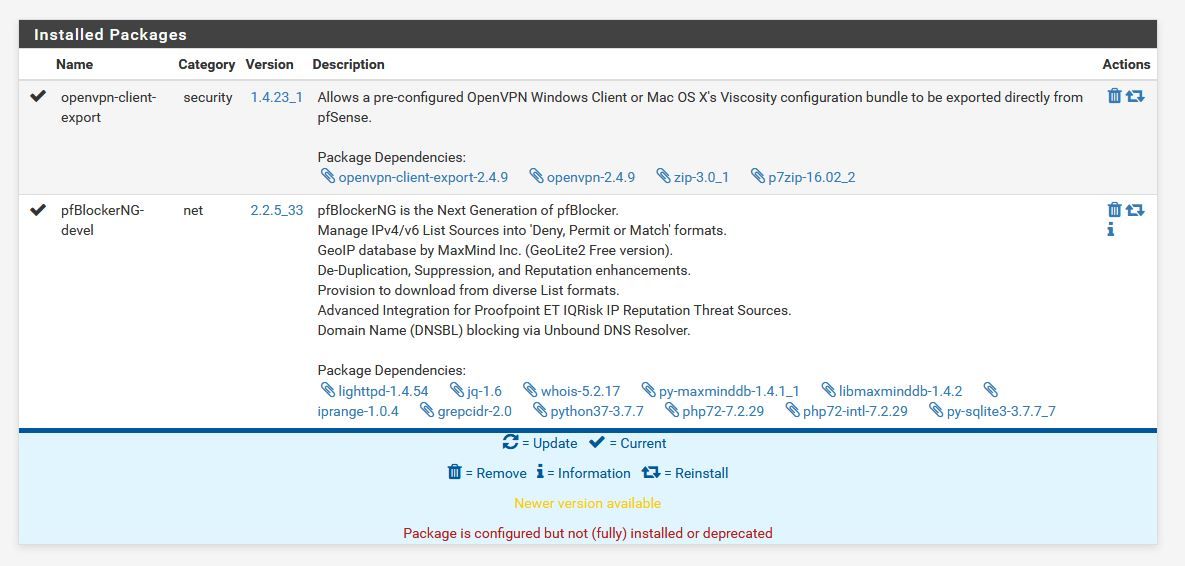

      On a SG-1100, running 2.4.5-RELEASE-p1 has anyone seen any issues with firewall rule changes not taking effect unless a full reboot is carried out ? Also getting lots of these messages :
      There were error(s) loading the rules: /tmp/rules.debug:25: cannot define table pfB_PRI2_v4: Cannot allocate memory - The line in question reads [25]: table <pfB_PRI2_v4> persist file "/var/db/aliastables/pfB_PRI2_v4.txt"
      @ 2020-07-08 17:56:51
      Running pfblockerNG. Table size should be adequate.

          Yes. It throws the same error message as above at the bottom on the page.
          As far as packages are concerned I have only two running and the live status generally shows ram usage at around 30%. Open VPN is available but rarely connected.
