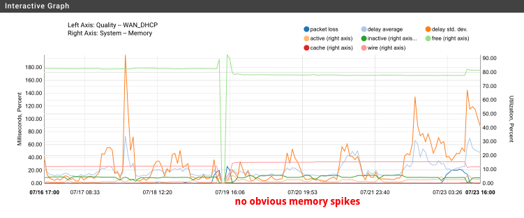

Since earlier this year I've been fighting increased latency, this clearly coincided with the release of 2.4.5 but I've also noticed increased latency of 2.4.5-p1 and 2.4.5-dev too. Here's my graph from the start of the year.
Having struggled to work remotely under 2.4.5, I upgraded to 2.5.dev which was averaged better but was still demonstrating some increases that made videoconferencing challenging. I rolled back to 2.4.3-p3 and life was good again.
I decided to try 2.4.5-p1 and although things are certainly better than 2.4.5, its noticeably averaging higher latency than 2.4.4-p3.
All of this is with a largely static configuration with no significant changes to rule size, packages etc. I'm curious, is this observed with other users, are negate aware, is this the new normal, or can we help provide info to help reduce this latency back to previous levels?

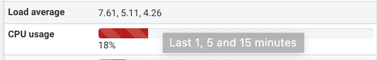

Appreciate you guys following up with some data. I've spent some time comparing my monitoring data but this doesn't show anything, although the dashboard CPU utilization is off the chart for this spec CPU.
can you enable HT??
CPU utilization does seem quite high at first glance. What packages do you have installed? Also, what does Diagnostics > System Activity show as using all that CPU time?
I've experimented with HT on and off over the last few months, it made no noticeable difference.
topshown pfctl and openvpn being the highest consumers of CPU. pfctl can peg a single core intermittently, OpenVPN less so. Downloading a large file over a I would expect OpenVPN would likely top out at 100% of one core due to its single threaded nature, not occupy 4 cores. Because the latency increases with traffic (even a 250mbps download), my suspicion is theres something going on in the background with 2.4.5 that isn't in 2.4.4p3.Its hard to grab an output that shows the peaky/dynamic nature of the top output, open to suggestions how to though.
Packages include: arping, avahi, cron, perf, mtr-nox11, netsnmp, nut, openvpn export and pfblocker-dev. pfBlocker is run with IP blocking only with PRI1 (16k), PR2 (267k) IPv4 blacklists. No DNSBL was enabled during the majority of this window.
Disabled PRI2 for pfBlocker.
Last 1 / 5 / 15 minute CPU average

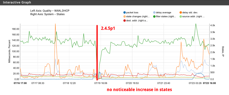

Yes, still on 2.4.5-p1. I made no changes to 2.4.5 as I migrated to 2.5-dev before 2.4.5p1 was released, as you can see from graphs 2.5 was better but still not perfect.

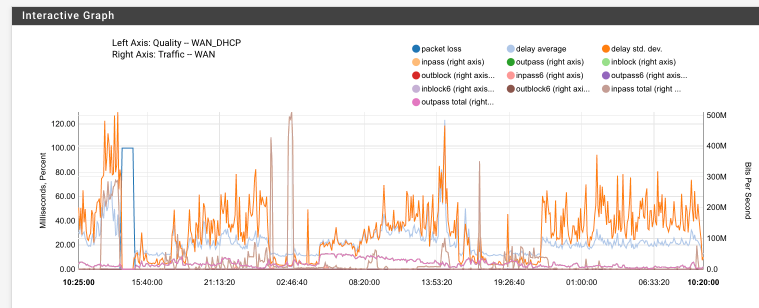

Then to validate I did a clean install of 2.4.4.p3 no rollback strategy in place), reinstalled bare config, and upgraded to 2.4.5-p1. 2.4.4p3 doesnt exhibit any of this additional latency.I am still seeing high pfctl usage, here's the last 48 hours.
I was curious if the latency only affected virtual machines but I'm seeing similar on bare metal too.
Latency vs traffic
