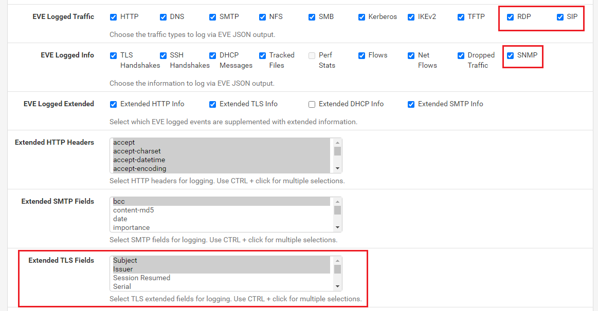

Screenshots of new EVE Logging options and APP Parser settings
This update adds several new EVE logging options for RDP, SIP and SNMP along with TLS Extended Data fields. See the screen shot below. You must enable the EVE output logger in order to use these features.
