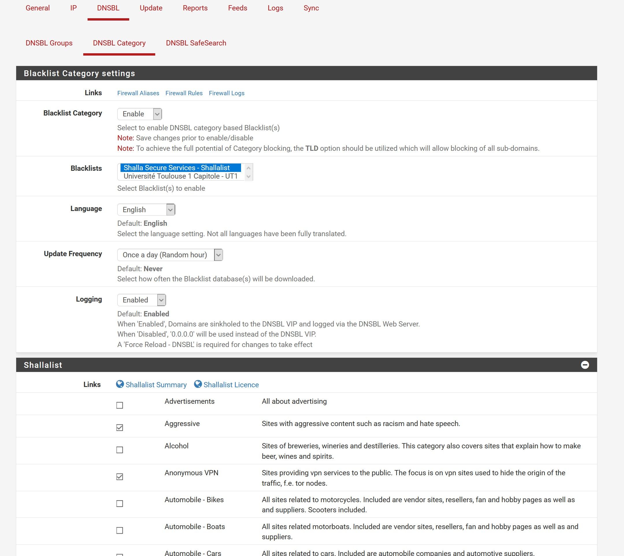

                          @bmeeks I think I did have it right PFBlocker is blocking everything in my lists the only thing not working is Shallalist and naturally to test it I was clicking on porn sites only listed in shallalist but when I click on websites in malicious website lists it blocks them perfect shallalist.jpg
                            In your earlier posts it was not clear that only certain pfBlockerNG-devel lists were not working. It sounded like you were saying no pfBlockerNG-devel DNSBL lists were working. The most common use here for DNSBL seems to be ad blocking of one sort or another, so I assumed that's what you were doing.
                            If you are having issues with a single list, you need to investigate the IP addresses that are bypassing the list and see why (highly likely they are not covered by the IP list). The most common problem with lists that try to block popular things is that the popular services (be they porn, Netflix or even a large news web site) use diverse CDNs (content delivery networks) that use IP address pools and servers from all over the world. So it is possible for a new CDN IP address block to not yet be on an IP block list. Conversely, it is also possible for an IP block that once served say "less legitimate" traffic to now be 100% legit. The result in that latter case is something you want to let in is instead blocked by the IP list. So it cuts both ways.
                            The very first post in this thread where you showed the static IP clients being assigned the 208.67.220.222 and 208.67.222.220 addresses was incorrect in so far as pfBlockerNG-devel setup goes. Those IPs are OpenDNS servers, and while they do have the ability to filter some objectionable content if you have the proper account with them, it would not have anything to do with pbBlockerNG-devel. When you use those DNS servers on a client, then pfBlockerNG-devel is 100% out of the loop for those clients.

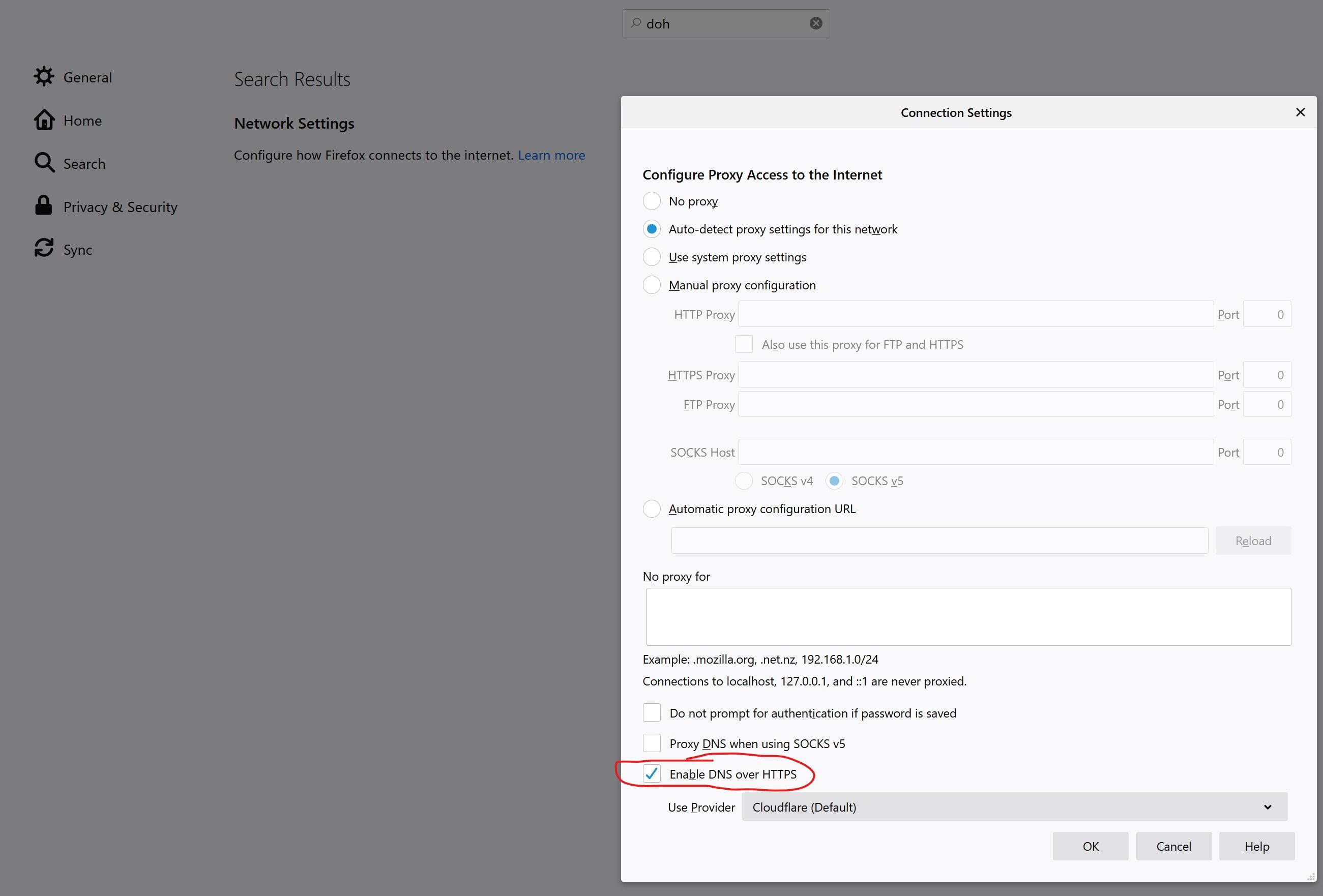

                              Last bug worked out I had a firefox browser bypassing bfblocker and DOH (DNS over HTTPS) was checked as soon as I unchecked that bfblocker also blocked firefox FIREFOX dns over HTTPS.jpg

                                Thanks for reporting back. It's a pain in the butt when your browser goes behind your back and chooses its own DNS server. That will undermine a lot that you try to do on the controlling side.
                                So it sounds like you had two issues. The first one was the DNS server misconfiguration on the static IP clients (the screenshots in your first post), and the other issue was Firefox doing its own DNS lookups over HTTPS (via DoH).

                                  See the very first post in the DHCP and DNS forum.
                                  Normally, this mode isn't activated by default in Firefox .....
                                    dgall @Gertjan
                                    @Gertjan Yes were correct but the way I had it configured all my browsers bypassed the pfblocker then after I put in 192.168.1.1 as my preferred DNS then only my firefox was was bypassing PFblocker
