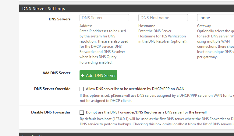

          On the General Setup page, these are the perfect settings :

          edit : I forgot to mention the reason why sometimes resolving works, and sometimes it doesn't.
          When multiple DNS servers are entered on the General settings page, they are used on a round robin base.
          If one of them doesn't work out, there will be no answer. The next request will use the next DNS in line, and have an answer.
          When you enter nothing here, the default 127.0.0.1 will get used (by pfSEnse itself == the resolver and the same resolver will also serve all pfSense LAN based devices). That will always work. That is, as long as the resolver has a free access to the main 13 Internet roots servers.
