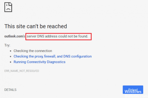

        What is the DNS error you're seeing?
        What is that client using for DNS? Is it being passed the pfSense LAN IP by DHCP (the default setup)?
        Other clients connected to the same switch, in the same subnet do not see this issue?

          the exact error is this
          when i do ipconfig /release , renew
          i will get the same ip,and for a number of secs it will work and then boom i am blocked again
