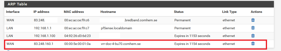

      Hello,
      I've been using pfsense for years, and suddenly my Wan stopped working.
      Yesterday it stopped working from nowhere.
      https://imgur.com/a/lKw2cSo
      So I did some troubleshooting, I tried changing DNS etc, changing cables, put a switch in between pfsense and my coax cable ISP.
      I did a complete factory reset if one of my configurations was wrong?!
      But nothing, so I checked ARP and thats when I noticed that if I remove/delete the WAN gateway ARP, it starts working again. (I might have timed it, 300 sec then it drops again).
      I also tried other software, some worked, some didnt.
      Does anyone have an idea why it wont work or do you know a work-around?

        cl1nt
        So...
        manually put in "net.link.ether.inet.max_age: 200" under system tunables seems to work.
        Is this gonna be a problem?

          The gateway MAC seems to be a VRRP or CARP. Do you use CARP on your site as well?
          Does the MAC change, after removing the ARP entry?
            cl1nt @viragomann
            @viragomann
            Im sorry, but i dont know the difference.
            How can i tell if I use Carp?
            The MAC not change.

              CARP is for a high availability setup, where at least two routers are sharing a virtual MAC.
              @cl1nt said in Arp Issue - No wan:
              The MAC not change.
              So it's strange that it resumes working though.
